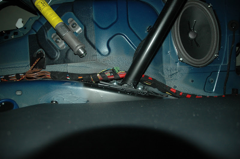

The Rollbar is the back half of this cage with only one of the diagonals. They are options that bolt in, as is the harness bar.
Note the tabs on the top corners of the main hoop that face forward. These were cut off, ground flush and repainted. I had no intention of installing the full cage making these tabs a possible hazard. To make the hoop and the legs actually fit we had to cut off the flat bases and grind them smooth. Then cut about an inch of the bar off the bottom, weld them back to the bases and refinish.
In the picture below you can see some of how we mounted the bar.
Under the car there is tapped plate that was welded to the frame. Before it was welded into place the location of the holes were determined and drilled. For increased insurance that it would not pull through a plate was welded to the interior as well. The bar was cut to fit and the cut off plate was welded back into place. After test fitting all exposed areas were coated with paint and finally bolted into place. To matters more interesting the bar was designed using an earlier Mini. The dome light shape has been changed sometime in the production run too. Being mine is a later car I have a slightly larger dome light housing. This required a slight angle back to clear the lamp and fit the hoop tight to the roof. You can find more pictures here. I wish we had taken pictures of the main hoop mounting before the carpets went back into place.
