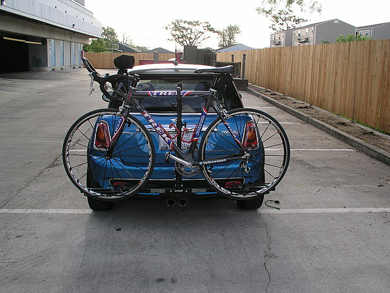

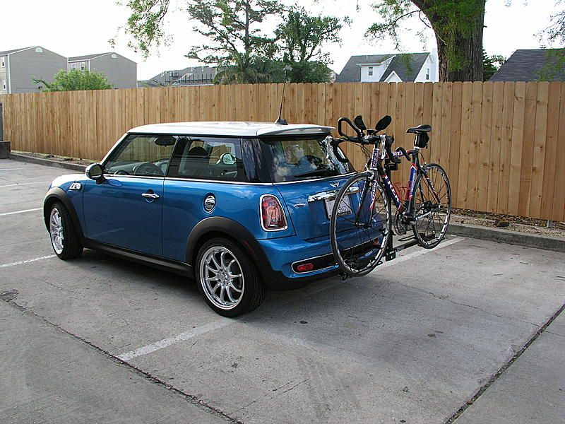

Photos of bike rack
Here are some photos:
Attached Thumbnails 07 MCS Hitch Receiver - For Bike Carrier-bike-rack-side.jpg   07 MCS Hitch Receiver - For Bike Carrier-bike-rack-quarter.jpg   07 MCS Hitch Receiver - For Bike Carrier-bike-rack-rear.jpg

Fbirch, that looks exactly like what I'm looking for. And it's pretty inexpensive compared to some of the other tray racks I have seen. The other ones that are similar are:
