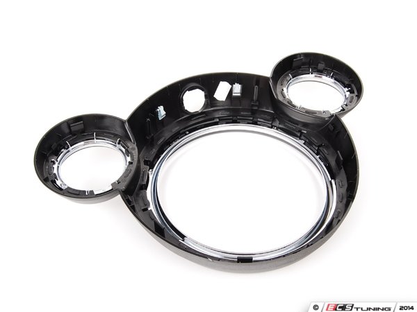

MINI Countryman Piano Black with Chrome Trim Set
This kit is a genuine MINI trim upgrade from the gray to the newer piano black with chrome, which matches the dash. These easily snap into location in place of the original trim. A complete set for an instant upgrade to the interior.
Incudes:
Center Mickey - Piano Black with chrome.
Left and right outside dash vents in piano black/chrome.

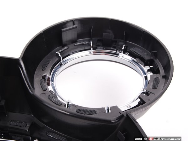

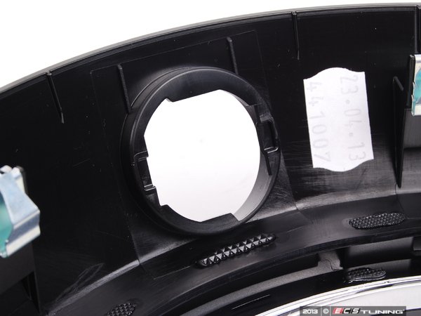

On the Mickey Speedo :
You can see here the back tabs. Work your way around. And make sure you unsnap the hazard button after you clip it out .
" The center speedo trim pops right off, but you have to watch the wires that go to the hazard button. You'll need to pop it off and then disconnect the wire from the switch. Start pulling at the bottom and work your way to the top. Then getting the switch off you need to squeeze both metal spring clips at the same time and push it out from the bottom. "
From that thread above.
