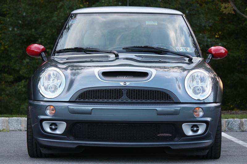

It is a relatively simple mod. I recently added this to GP0411
JCW Grill, TOP: OEM Part# 51-13-0-140-259
Flange Nut (you will need 11 of them) OEM Part# 07-14-9-116-541
You need to apply pressure from behind the flange nuts as you remove them.
Before:
After:

Here is the Aero Grille - Top section
http://www.ecstuning.com/Search/SiteSearch/51130140259/ES76994/
Top Aero grille hardware - flange nuts , you will need 11 of them.
http://www.ecstuning.com/Search/SiteSearch/07149116541/
The bottom section Aero Grille * require a little modification to fit Cooper and Cooper S bumper.
http://www.ecstuning.com/Search/SiteSearch/51110140255/ES73435/
If you are talking about a slat delete I think you are referring to the JCW GP front bumper, which comes with the molded center slat around in it. Near where the license plate would be.
JCW GP Front Bumper Panel - Primed
http://www.ecstuning.com/Search/SiteSearch/51117182621/ES74791/
It in the picture above with the factory JCW GP " Thunder Blue metallic : even though it looks like dark silver-ish.
The Yellow modified MINI has that bumper also , just painted differently.
