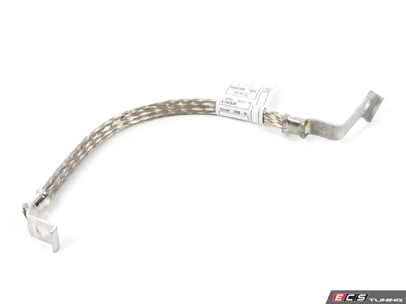

Check the ground strap: https://www.minif56.com/threads/f56-...ocation.95368/
https://www.realoem.com/bmw/enUS/sho...diagId=12_2658
https://www.ecstuning.com/b-genuine-...e/12428602991/
Or
https://www.ecstuning.com/Search/Sit...h/12428741637/
