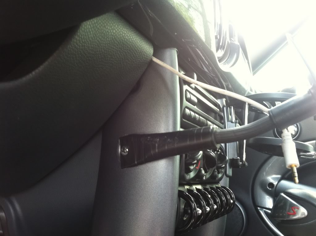

Here are the pictures of the mount. I used part of one I bought, so part of it has the arm that can bend left/right and up/down which you can see is the skinnier part, plus the front where the phone rests rotates 360 degrees. I decided to wrap the bottom metal part in black electrical tape to help protect my pillars, so it was not just metal rubbing. It is plenty tight to not move when driving, but just lose enough to where i can still tilt it up and down more if I need to. With the bottom of that mount open I have my car charger plugged in, and I just left the aux input loose and brought just enough out to plug in instead of mounting it anywhere, because it was just extra work. It does not look store bought up close, but when you are just sitting in the car, you cant tell, so I am quite pleased with how well it turned out.
I took a piece of pipe and cut it to about 3.75". The actual mount had a tiny screw where it screwed in to the old suction cup type mount, so I drilled a hole in that pipe and screwed it in, which made for a nice snug fit. Then the other end I hammered it flat and hammered it over a pipe to give it a little curve to kind of match the curve of the pillar. With out that, the mount would stick straight in the back of the steering wheel which would not help, and then I drilled a hole for the bolt. The bolt did have to be slightly longer than the stock one, I could not get it to screw in, I will paint that screw black. And if I ever need to remove it, it takes 30 seconds to unscrew the one bolt, and there is no evidence of it!
TYVM for the pixs!
Black Sharpie. Way easier!

Np!
Black Sharpie definitely way easier! Good idea.
