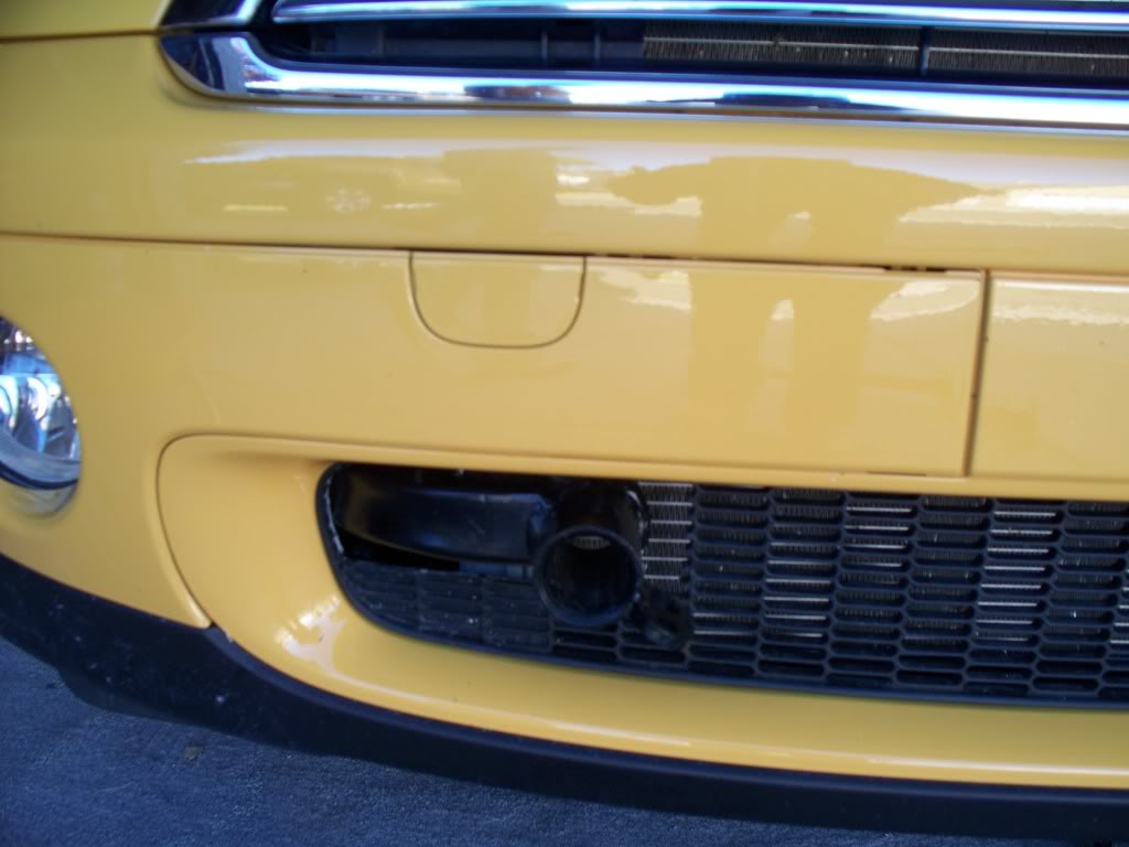

I have dolly towed two different MINIs across country. No problems with the dolly tow. Locking the wheels or not isn't a big concern. You check the harness every time you stop.
I currently flat tow a manual Clubman. I use the Roadmaster base plate, and tow bar. The base plate will fit the frame on both the Clubman and the S, the bumper cover has to be cut for the connectors.
I know how much NAM members like to debate, I will not debate this. It can be done, it works well, and I don't particularly care what anyone's MA said.
Good luck, enjoy the Clubman! The lack of locking steering wheel is great for flat towing. Just hook up, put it in neutral, and go.
