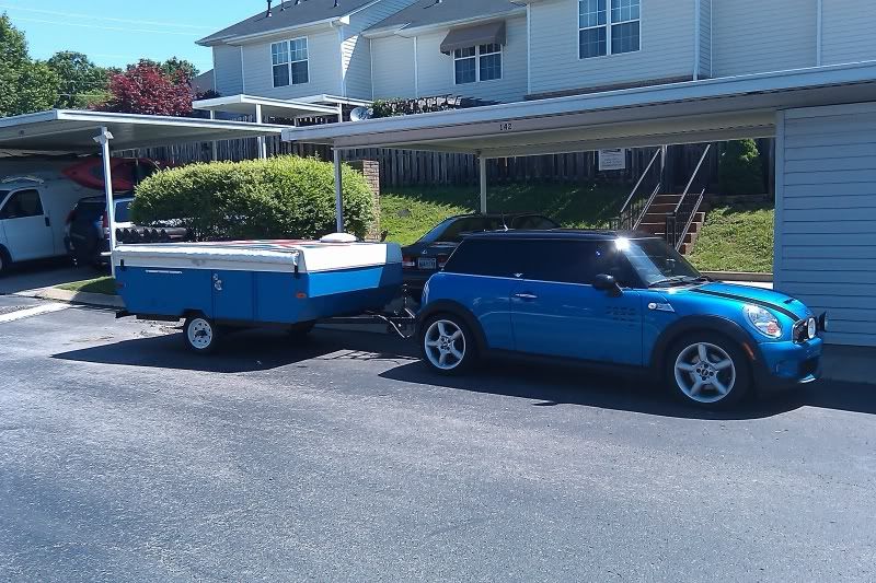

My old pop up...
My summer project...
No problems towing in my experience. Go for it.

The pop up was about 800lbs dry and probably 1100 lbs loaded. The new camper is probably close to that if not jus a bit more. I also have a utility trailer that I've hauled everything from lumber to motorcycles to pianos. In all cases, the trailers tow just fine even at highway speed (70 to 75 mph). Biggest thing to worry about is tongue weight and weight distribution to avoid sway....but that's the case regardless of what you tow with.

The popup shown above was pretty old....an '88 Starcraft if I recall correctly. It was only an 8' long box.....no grey water tank or gas tank, etc. I "remodeled" it....besides painting it to match the car and painting a huge Union Jack on the roof, I removed a sink cabinet inside as well as the icebox and the water storage tank. That probably dropped it by 100 lbs with those removed. I think modern popups weigh a bit more these days....people expect more conveniences and nicer finishes, therefore there is more weight.
I never had any trouble seeing around the trailer with the side mirrors, the issue was seeing over it with the rearview mirror.....that's not necessarily a deal breaker, though. I lowered the axle on that old Starcraft to accommodate better/larger wheels and that raised the height of the trailer to the point where I could barely see over it in the mirror. On the sides, not much of a problem, though. I originally installed a rear view camera on the license plate bracket of the camper, but ended up never using it because it didn't really help that much. The blind spot behind the camper was really only a few feet and unless a gokart was tailing me, I could see what was behind just fine.
I've towed up to about 1500 lbs (estimated) without feeling uncomfortable doing so. I did have one instance on my way to the MOTD event a few years ago going downhill on the interstate in the mountains where I did get a bit of sway.....that was partially my fault for going too fast and not loading the trailer properly....too little weight on the tongue. Lesson learned.
