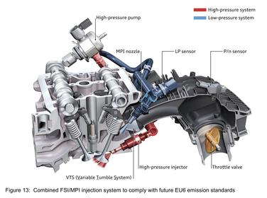

Plus the N14 currently accepts more modifications (if you're into such things) without overstepping the boundaries of the ECU.
And yes, VW / Audi do have low-pressure fuel-port injectors on their new EA888 engine.
