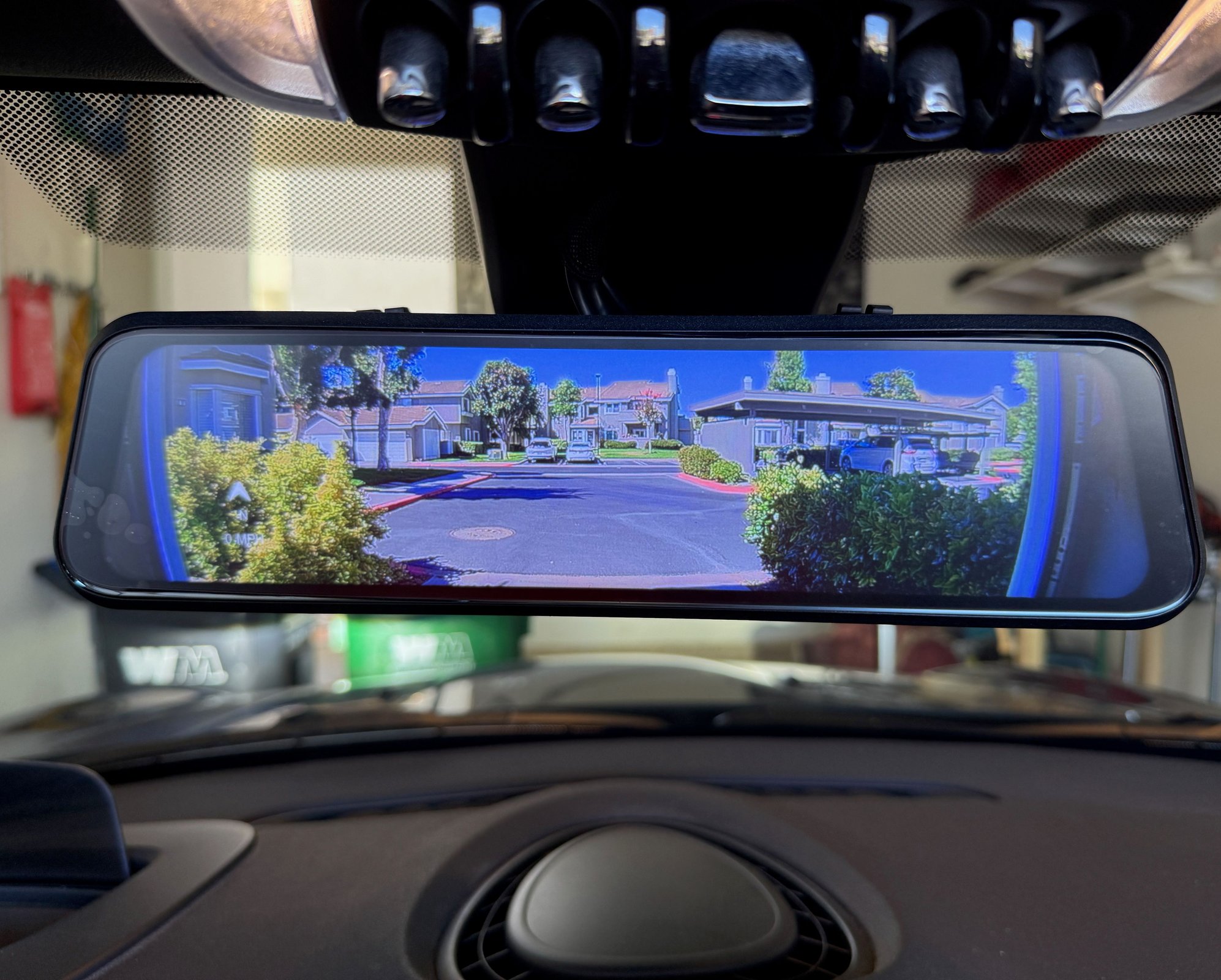

I added an Acumen M4 2ch rearview mirror dashcam to my MINI today, hoping its rearview camera could overcome the inability of the original rearview mirror to see through our MINI convertible's opened top. The good news is that it does. The bad news is that its display in its default setting is too dim to see well in full sunlight, and can't be adjusted to be bright enough to see well in full sunlight. Plus, under its display is a mirror that reflects a LOT of glare in full sunlight. From reading reviews, it appears at least one competitor's product has the same issue.
The manufacturer is looking into the possibility of a firmware upgrade to retain the current brightness setting when the car is powered off, and suggests adding an anti-glare film to the mirror. I'll be trying that tomorrow, though my success at installing large protective films without resulting bubbles isn't the best.
Has anyone found a rearview mirror dashcam with a really bright and glare-free display?
Update: The M4's default brightness is just right for night driving, and no glare issues at night either.
Last edited by straz; Aug 14, 2025 at 10:06 PM. Reason: To clarify M4 display works well at night
Update 2: Installed a nonglare film today, and it really does kill the glare. Installation wasn't difficult, and mostly successful (just a few tiny bubbles and specs of dirt left under the new film.) This film is an exact fit: www.amazon.com/dp/B09J7ZVC5W

Photos of rear camera and dash cam rearview mirror
Here's the rear camera, atop the license plate.
Here's the rear view from our garage via the new rearview mirror dashcam
The one thing I'd do differently if redoing this installation would be to have the pro shop also install the antiglare film.
