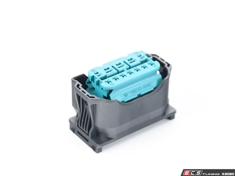

Do you happen to have the part number or a link where to purchase it? thank you in advance.

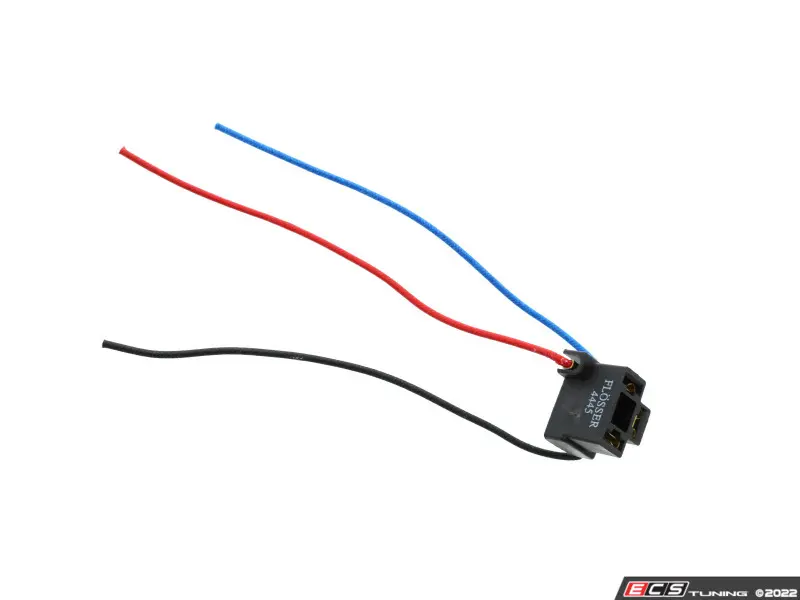

Looks like
https://www.ecstuning.com/Search/Sit...h/61132472911/
For just the bulbs
https://www.reddit.com/r/MINI/comments/1kyfv9i/2015_f56_headlight_connector_burnt_up_anyone_got/
https://www.reddit.com/r/MINI/comments/12zliiy/anyone_else_had_a_melted_headlight_connector_and/
H4 this is the one.
https://www.ecstuning.com/b-flosser-...each/4445~fls/

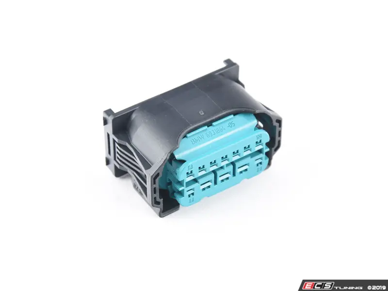

thank you for the quick response... but it's actually this

Ok then you need that H4 one linked above.
