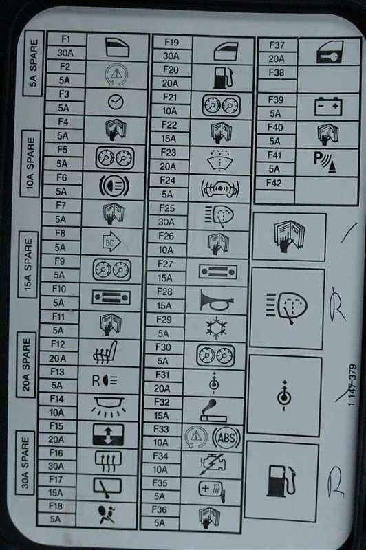

I have researched and researched to see if this could be a fuse first. The Mini Fuse diagram (the piece of white paper in the fuse box in the glove box) indicates that the fuse is #31 (or F31). I say it "indicates" (it is a picture only) as fuse no 31 has a small picture of what looks to be "windshield wiper fluid spraying." But the slot #31 in the fuse box does not have a fuse in it at all. The back of the fuse box diagram piece of paper says the fuse "amperage" is 50, which seems very large for a tiny little fluid pump. But again, that fuse #31 slot has nothing in it (no fuse). Further, when I look at the used fuse panels on Ebay that contain all the fuses in the fuse panel, those panels on Ebay also have nothing in slot #31. So maybe slot 31 and the picture on the diagram has nothing to do with the Washer Fluid Pump???

After seeing something in my searches, I am starting to wonder if slot F31 in the fuse panel is for European Heated Windshields and N/A in the U.S.? (since the fuse diagram also shows what looks to be a heat symbol in additional to the washer fluid symbol).
Can someone with an F56 look under their passenger side dash and tell me if there is no fuse in slot 31? Or if you have a fuse in slot 31? (gonna need a flash light under there; or iPhone light) I have no fuse in slot 30, 31 and 33. I have a 40 amp in slot 32. The diagram / piece of paper is in the fuse box, which is through the door at the back of the glove box.

So, I never could find if there is a fuse related to the Windshield Washer Pump. One dealership said slot 31 is probably for "heated headlight washers," based on the pictogram on the fuse diagram.

I looked at the fuse diagram behind the glovebox and F31 does look like heated washers
I found another fuse layout which i think relates to the fusebox in the engine bay - looks like F23 20amp fuse for washers

F31 on the F56 is a heated windshield (EU Option)
I can not find the water pump fuse in MY car either.
