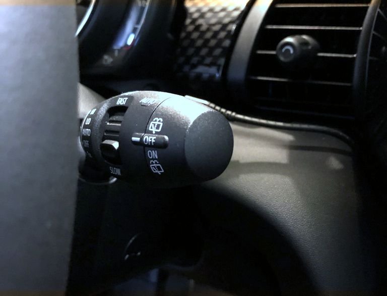

Looks like Mini changed the stalk design for 2019. Mine has the button at the end of the stalk and the stalk position indicator listed Off-Lo-Hi going upwards.
Totally agreed in Auto mode, the wipers would go like crazy even in the slowest setting. Will complain to the dealer during the next service.

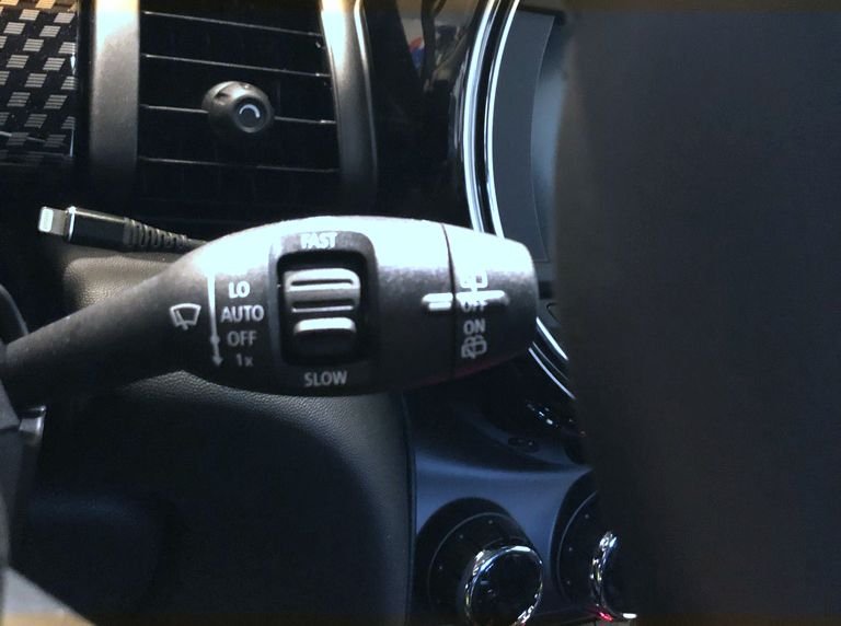

Thread from the predominantly British chaps over at F56,,,,,
https://www.minif56.com/threads/auto...itch-do.62361/
Auto wiper - setting the frequency
Setting the frequency or sensitivity of
the rain sensor
Turn the thumbwheel to adjust the frequency or sensitivity of the rain sensor.
Up: short interval or high sensitivity of the rain sensor.
Down: long interval or low sensitivity of the rain sensor.
As others have mentioned - only diff for your late 2019 onwards is that the button on the edge doesnt exist. To control the on/off (shown by the green LED) move the stalk position to the AUTO position
non auto intermittent
so - you have one extra label on there that us pre late 2019 blokes dont have.
Light reflection is blocking the list of options you have: Not int/intermittent in there? sucks.
Leaves the trusted bmw one swipe by pressing down option

MINI (and BMW in general) moved away from the button on the end of the stalk. Regardless of how your particular car activates the rain-sensing wipers, there is no way way from the factory to have regular intermittent wiping. Regardless of the old wiper stalk or the new one, your options are: off, rain-sensing, low, high. The only thing that's different is how you turn on rain-sensing (older ones had the button at the end of the stalk, newer ones you move the wiper stalk up one notch). With coding you can decrease (or increase) the overall sensitivity of the rain sensor. You may also be able to code it off completely, but I think that would also remove your automatic headlights since they use the same sensor.
Regarding Rain-X, if I'm not mistaken it's not supposed to be used on cars that have rain-sensing wipers because it confuses the sensors. Personally, I don't have any issues with the rain-sensing wipers in my 2019 F57 (or my BMW or my VW, both of which also have rain-sensing wipers). I keep the sensitivity adjustment **** on the lowest sensitivity (in all three cars).
