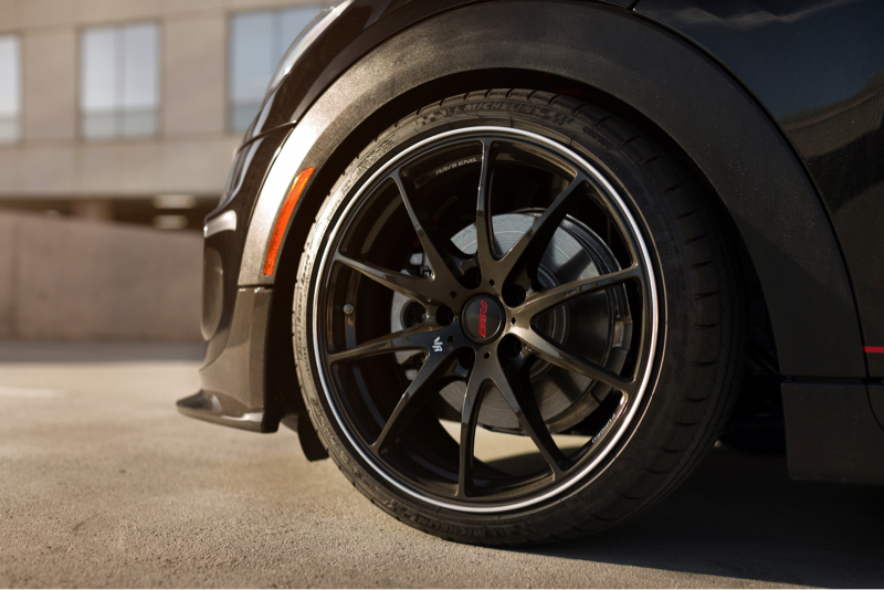

I run 18.5 x 8.5 et45 (but with a 3mm spacer in the front to avoid hitting the strut of the JCW Suspension). I have a 2016 MCS. And I'm running Volk Racing G25 wheels.
Definitely have some poke in the front -- waiting for Vorshlag to come out with its camber plates to lessen this.

This is about the best answer. I would add a 5-8mm spacer in the rear to make it flush like the front. The rear needs a more aggressive offset than the front by about that much if you don't want them to sit farther inside the fender than the front.

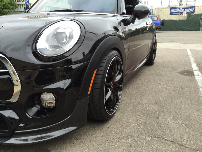

Michelin PSS 225-35-18
Semi-Daily and no problems
And I have no clue about your suspension.
