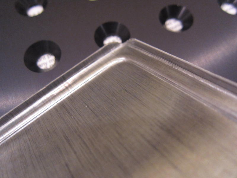

1) The first thing I did was install the license plate on the mounting plate with the four black screws provided (they provide silver screws as well). Then I used a hammer and beat the edges of the license plate over edge of the mounting plate. It is pretty malleable. I did the opposite sides so that it locked the plate in place and would not shift as I bent the edges over. Tap it over a little at a time around the full edge of the plate until it is all the way over the edge. Why do this? Optional, but the license plate is slightly larger than the mounting plate and leaves a sharp edge. This edge may catch something, maybe your leg? Or if you happen to do an automatic car wash it could catch one of those brushes. The resulting lip adds some strength to the license plate to resist anything that may tug on it. Plus it just looks a little more finished. Not to mention the smaller surface area drops your 0-60 time by 1 tenth
The US Mill Works plate is solid and thick and allows you to do this. You might be able to do the same with other mounts. Like I said this is purely optional but it gives it a finished look.

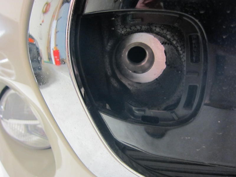

2) Remove the license plate from the mounting plate so you can install it on the car. There is a plastic cover over the tow hook hole. It just pops out by pushing on one side. Then there is a lanyard you need to remove. Keep the cover somewhere for safe keeping.
3) Follow the instructions to pre-assemble the parts onto the screw that goes into the car. You can get the screw in most of the way with your fingers. Then you need to install the mounting plate and snug up the screws and use the plate like a wrench to tighten the screw. Because of the curve of the bumper you can't just spin it on. You have to tighten a little at a time. Loosen the mounting plate, adjust it, tighten the mounting plate then turn the assembly again to tighten the main screw into the tow hook. Once you have it tightened then you can looseen the mounting plate and adjust it to its final position. I found the farther most set of holes allow the license plate to easily clear the fog light and the trim around the grill and looks like a good position.
