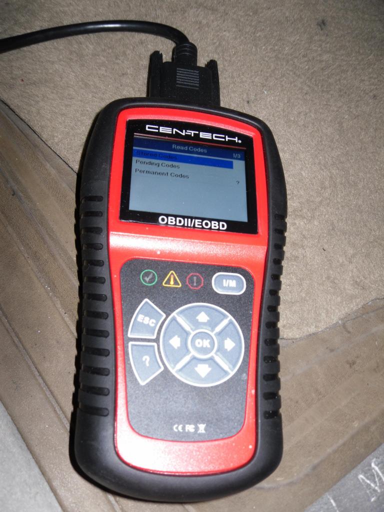

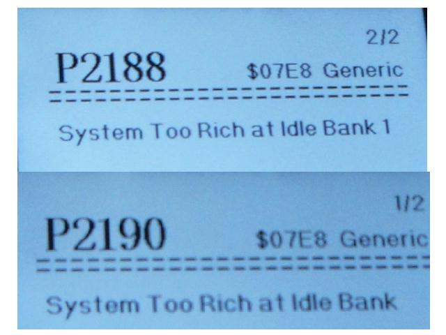

Regardless, I did witness numerous times Check Engine Light showing up on my MB for 6+ months during the entire time that I had the K&N filter. Hooking up my hand held OBD II coder reader and turning it off was my weekly ritual on that car. Actually it often caused severe drivability issue as well in addition to the Check Engine Light. The error code was always F/A related, switching between too rich or too lean, which told me that the ECU was confused. That's why I tend to believe my brother in law.

"Too rich at idle" would actually imply a restriction or reduction in airflow relative to fuel ratio. If the K&N is actually letting in enough air to cause issues for the ECU, then the issue should be "too lean", not "too rich". I'm not arguing with you, just saying that I don't believe that code is being caused by "the increase in airflow", if that's what the tech was implying.
Now, it's possible that the MAF sensor got fouled with some filter oil and in that case, it's an easy fix, but I don't believe that just installing a free-er breathing element is what caused that code. Just my 2-cents.
