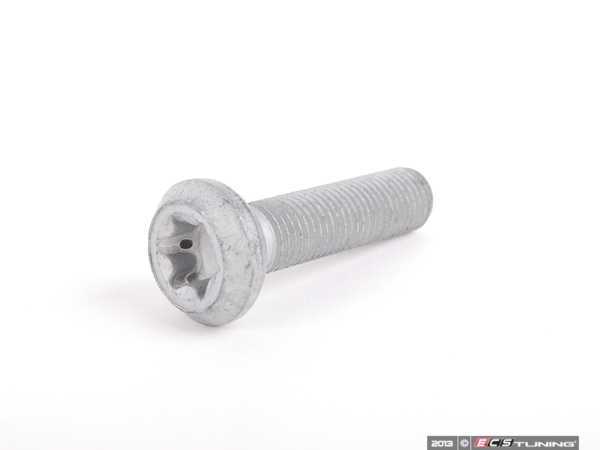

Here some diagrams, see which bolt it was. MINI has changed the axle drive section. Used to be a nut on the end of the axle / wheel hub connect pre F56. Now it looks like they went the VW way with the bolt in the center. Still has the bolts that holds the hub to the carrier.
33406858534 #7 in the digram
http://www.ecstuning.com/Search/SiteSearch/33406858534/ES2715021/
# 6 x 4 31206783065
http://www.ecstuning.com/Search/SiteSearch/31206783065/ES2683911/
Thank and let us know what the part number was.

Picked up the car yesterday evening and the repair seems to have solved the problem. From what the dealership explained, the hub bolt was improperly torqued from the factory. The bolt (#7 on the diagram) is a one time use bolt, so once they removed it to examine the bearing a replacement had to be ordered from the factory.
