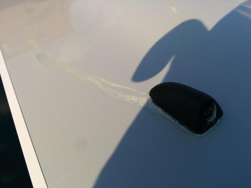

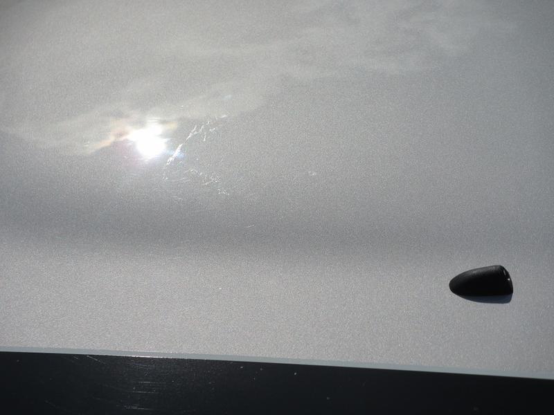

Hey everyone! I would like to have your advice on my situation… I bought/received my new Mini Cooper 2014 (F56) on July 25th (less than 2 weeks) and found that there was a marks (look like glue) on the hood. It is only visible when it is very sunny outside and/or under the light (ex: garage) so I didn't see it when I picked up from the dealership. I went back to the dealership and they were not able to remove the marks and said that it was an issue with the paint. They called me today and advise me that it will be fixed under the warranty and I have to take an appointment to their bodywork shop (BMW certified).
I’m a little bit scared about getting my brand new car (hood) repaint. I heard that an “aftermarket” paint job is not good as a “factory” one which could cause some issue later (chip easily, flake, etc..). I’m also worried about being able to see the difference (color) after they will repaint my hood (or spot that is affected). What are your advice on this? Thanks!

Are those marks on the drivers' side near the windshield nozzle? If so it could be a bad nozzle which leaks windshield washer fluid and etches into the paint. I had nozzle replaced along with the addition of a pressure damper.

It could just be in the clear coat so it may only need a little wet sanding and some more clear coat.

Anyways, from the pics. You dont look like u need a repaint. Worst case scenario just some wet sanding and buffing and you will be good as new

I'm with Fenderpicks. Looks from the photos like the marks are in the clear coat. A bird dropped on my car near the hatch handle I had to wet sand with 3000 grit then polish with an electric polisher. I probably removed half the clear coat but the mark is gone.
Thanks for the advice guys! I’m a little bit more confident on getting my brand new MINI fixed. I spoke with the dealership today and they said that they will repaint the whole hood. They suggested me to call the bodyshop and ask them my questions (quality of the paint, etc..). Hopefully everything is going to be good and I won’t have any other trouble with my new car.

I had the weeping washer nozzle problem right from the start on my F56. It's been back to the dealer who brought it to a certified BMW body shop. They wet sanded it twice, I'm not excited with the results. I'm thinking the only way to get it right is a respray at this point. Again not excited to have my hood resprayed either
I found that I also have the windshield nozzle issue on my MINI... When I got out this afternoon (sunny and very hot day), I noticed a leak dried on my hood (see pic). Not sure if this could be related to my first issue (marks on the hood).
I'll call my dealership Monday and try to get this fixed before they repaint my hood.
