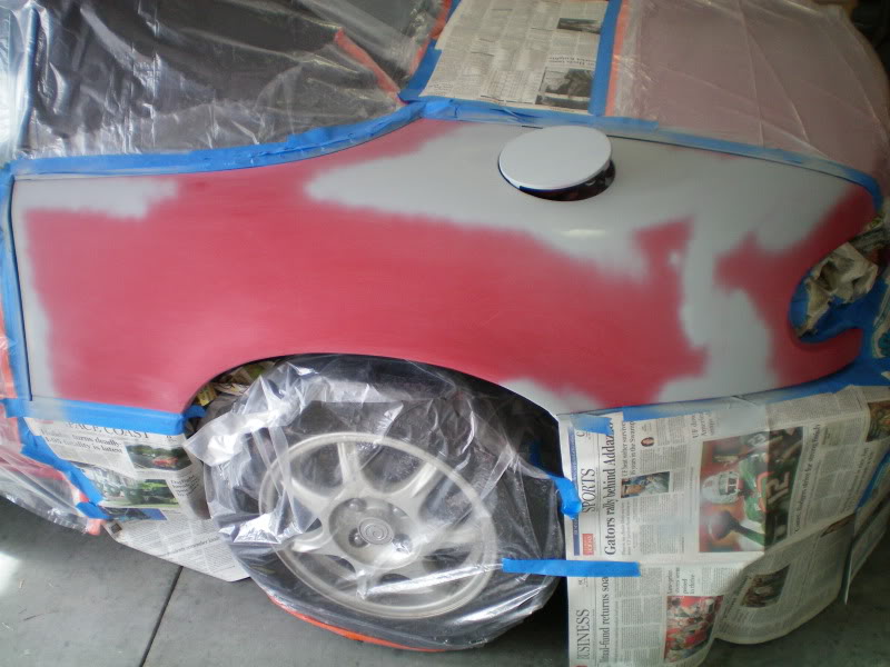

Originally Posted by chicohuahua
Guys, I appreciate all of the feedback! It does make sense to keep the original color since I don't have any paint experience.
Perhaps I'm just unhappy with the Electric Blue because the condition of the paint is so poor! The blue seems quite faded and what's left of the clear is really dull.
COULD BE that all that's needed here is a GOOD BUFF ..... clear does not normally wear out .... unless it is re-paint clear that is de-laminating . . .
AND if you are "not an experienced painter" your first effort is gonna be **** poor ..... unless you are the 1 in 1,000,000 with natural skill.
I took an adult education class in auto body repair and painting ..... 5 times! We had access to a full paint booth and professional equipment courtesy of the county school system VOTEC High School, and took in donor cars for a "free" paint job (they paid for the materials only). After painting about a dozen I'm still cautious of what colors I try to shoot and how much area .... black and most metallics are a PITA to get right.
Now a nice plain red .....
Footnote: YES, I am painting in my garage which is dumb and dangerous ...... you CAN blow the whole house up!
