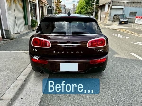

Please let me take a ride for a while.I'm on a Cooper D, but can I replace it with a muffler for Cooper SD?
We are considering replacing the rear muffler.
After all, clubmen have a nice butt!
I want to have a cooler butt!

In the end, I also decided to attach a Cooper sd scarf to the Cooper d.I bought a used muffler and bumper.
I'll do my best to DIY.
Have a nice day!

Good evening!I was able to safely replace the muffler and bumper of the Cooper SD to the Cooper D, so I will report it here.
It wasn't a little easy, but I'm satisfied with the best back!
I hope that the owner of this thread has also been able to replace the muffler safely.

The dual outlet exhaust looks much better, balanced.
