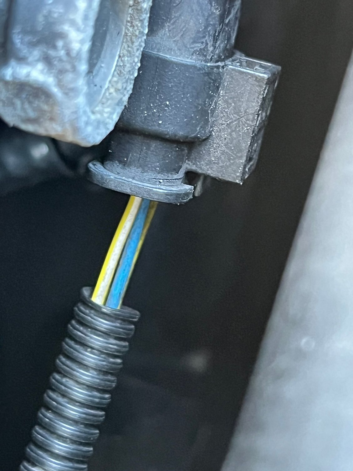

I started yesterday to install my first mod, a Dinantronics Sport module and it has not been going well.

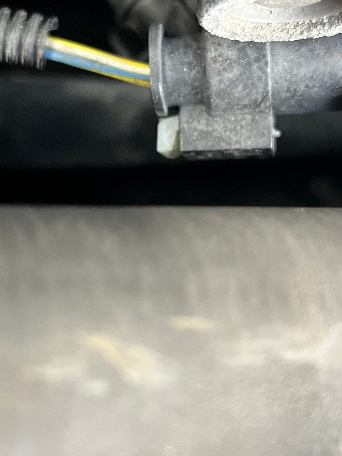

My problem is that I am a big person / have big hands and it is has been difficult to disconnect the wiring harness from the pressure sensor. I've got the instructions from Dinan, watched many YouTube install videos, just don't have enough space to work my hand to slide back the light gray clip. After an hour + and trying every small tool I had, I went and bought a pick and hook set. Today after another 30 minutes I managed to gently slide the clip back... but as I was using a pick to put some downward pressure on it to release the catch holding the connector, the light gray clip came out all the way, and is now lost somewhere in the engine bay.
The connector to the pressure sensor is still firmly attached, the car drives fine.
So some questions:
Do I need to take the car to the dealer and get that connector replaced?
Is it possible to get a small screw driver into the connector to release the connector and continue with the Dinan Sport install?
Thanks in advance for any thoughts.
Connector without light gray release tab
Not much space with the radiator hose

Don't beat yourself up too much, I did the exact same thing when I originally installed my Dinan Sport. I simply used a small zip-tie to hold the connector together. Once I got tired of the check engine lights/errors, I pulled the module and went back to stock...using a zip-tie on the factory connector and haven't looked back. My guess is that you would need to go to either a dealer for a new connector/harness or maybe a pick-n-pull yard to snag one off a wrecked car. Wish I had better info, but figured I would relay my experience.

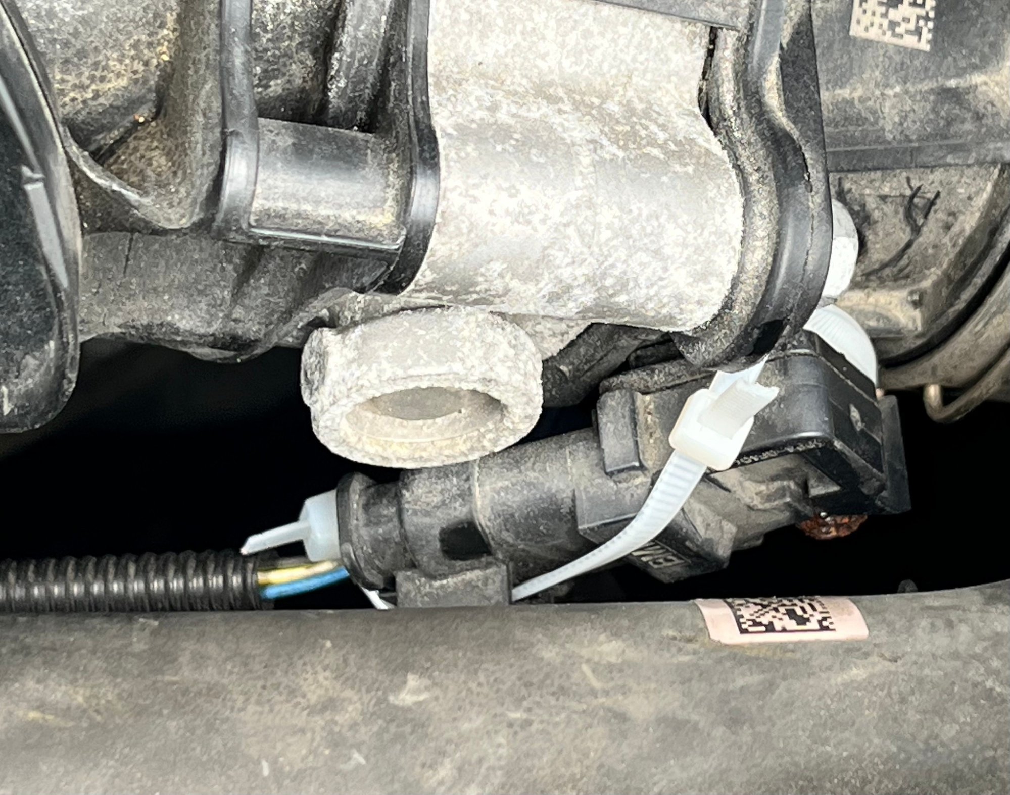

All Done ✔️
Got the turbo boost pressure sensor connector zip tied in place and just waiting for DINAN to send me my RA number for my D Sport return.
Two smaller ties worked better for me than one larger.

You beat me to getting a pic, but pretty much the exact same setup on mine, except my ties are black. I used (2) ties as well, since trying to thread a single one was too much of a pain. I too wish the Sport module worked w/o tripping lights, having the extra 5lbs of boost on the 'max' setting was nice. I have my Mustang for making angry turbo sounds anyway, no need to shorten my DD's lifespan.
