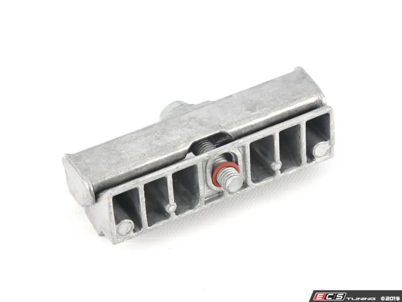

Also i would use anti seize on the bolts that go into the rivnut on the mounts. Gen 1 and Gen 2 MINIs have the same issues on the box and the nuts stick.
https://www.ecstuning.com/b-permatex...8oz/80078~pmx/
Diagram for box and battery holder to use anti seize.
https://www.realoem.com/bmw/enUS/sho...diagId=61_3792
https://www.ecstuning.com/b-genuine-...l/61219312294/
