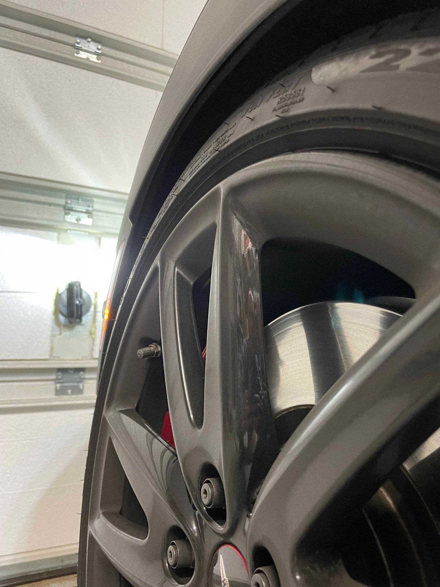

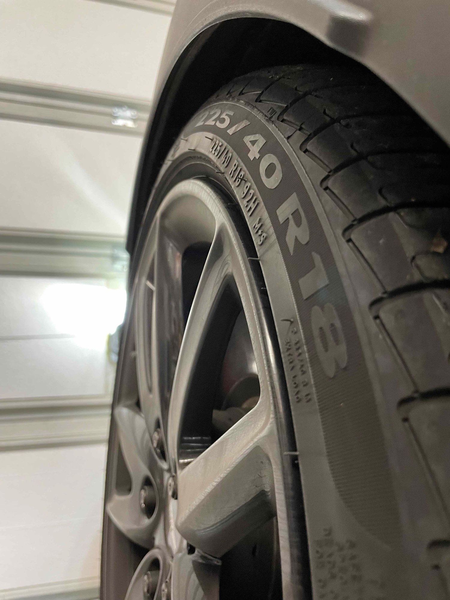

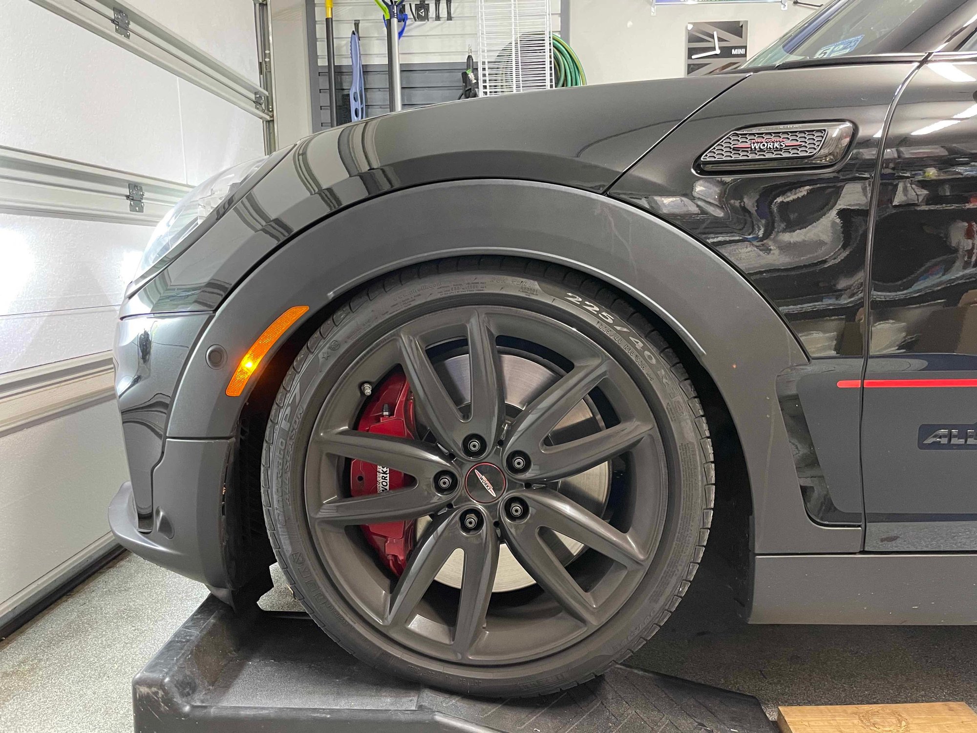

@CoralRedF54 Have you already bought the wheels and tires? Would appreciate seeing the end result. In your discussion, I don't see what width of tire you are planning to use. Lots of factors playing a role here: tire section width, actual tread width, wheel width, camber (tip o' the hat to @THE ITCH ), offset... Actually, I would say that the wheel width plays less of a role than the others. 15mm may have more impact than what suits your taste.
[To aid future searches and discussions...]
I find this wheel-size.com site very helpful for comparing wheel sizes... I'm sure I found it through someone else linking it somewhere on another NAM thread. I like having some numbers to at least use as a starting point for comparison, even though there's always a little variability.
@tom992 's pictures and wheel info in this thread are helpful to me. ( I'm considering wheel upgrades in the same ballpark of offset and tire width. )
For reference and maybe some help to others, here are some pics I took of my current setup. I wanted to see what kind of clearance I have and what I would be comfortable fitting. Like... would a certain set of GP3 wheels listed in the marketplace be something that I could use...
OEM Grip Spoke wheels, 18x8 ET54 (per wheel markings) with 11mm spacer... effectively ET43.
Tires are OEM Pirelli all-seasons. Tire Rack notes these have a 7.3" tread width for the 225/40s. Compare that to something like a BFG Comp-2 A/S that Tirerack lists as an 8.1" tread width for the same 225 section width.
Lowered on H&R sport springs.
Wish I had thought to put a ruler in the pic when I took these!
Hope this helps anyone else thinking about wheels. Likewise, I appreciate any pics and specs others post to this thread. Not trying to hijack your thread CoralRed, but I think you've started a good conversation. From what I've found, tire and wheel fitment pictures / discussions have been a bit scattered around the F54 section.
