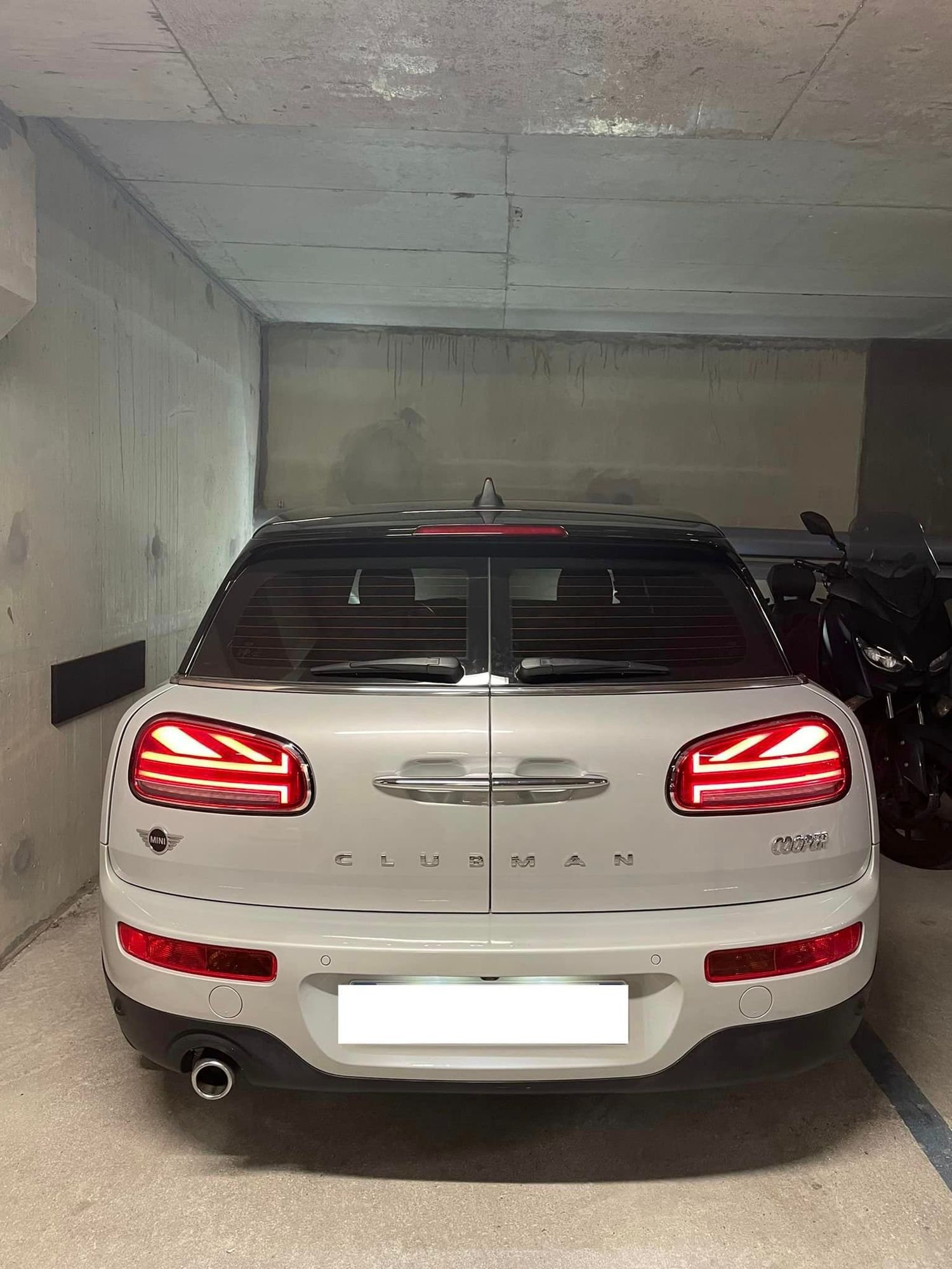

  #145
FRPhilippe's Avatar
FRPhilippe
Joined: Feb 2024
New (almost) retrofit success
Hello to the entire Mini F54 community
My name is Philippe.
Thanks to this topic and @maaii ’s example, I also embarked on the adventure of retrofitting tail lights. The method is indeed very simple and in addition it is reversible. Switching the pins in the pillar was the most difficult part, and still it is enough to identify the numbers. We can't go wrong. And the pins can be taken out without forcing with the right technique. The part of the cable puggling as Maaii proposes is the easiest part of the job.
However, I had to forget something with bimmercode because the brake lights do not take the full width and simply the shape of the fog lights of the LCI versions.
Could someone please help me by sending me the exact Bimmercode instructions to correct this? That would be great🙂
Best regards✌️
