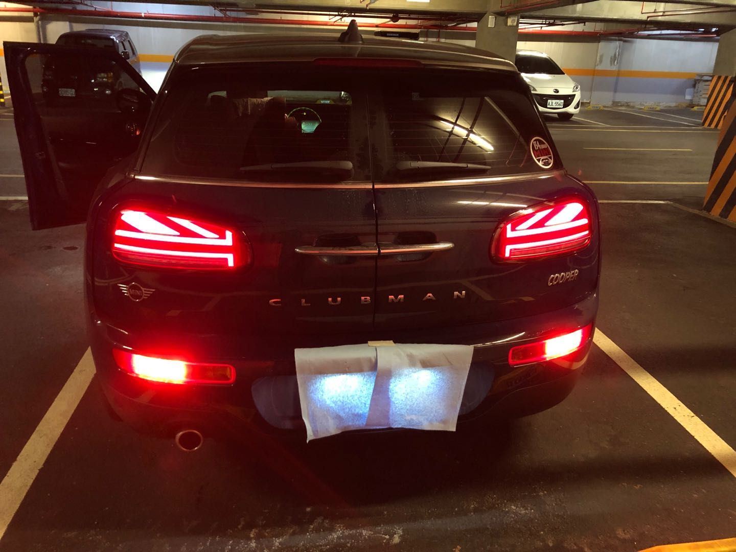

Problem solve. I made two adapter cables to retrofit UJ Tail Lights. It's so easy to do.
After coding, no error message pop up.

Change Brake lights and fog lights on BDC_ECU side. The fog lights will on bumper.

What about, when you open the doors, do the lights in the bumper then still go on? this is a safety feature so the car is still visible when the doors are open. Does it still work after this mod?
------> Yes, use fdl coding can solve this issue. Please check the pic as below.
All function works and without error. only fog light on bumper is different with LCI.
fog light
reveresing lights
Brake lights
Turn indicator
https://imgur.com/Km9ia9s

It's very simple, the original brake light is on bumper and fog light is on upper Taillight. You need to swap two Pin define on BDC ECU.
