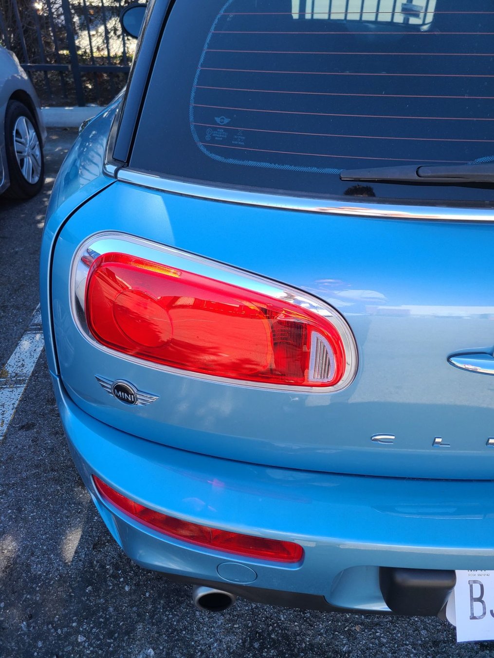

Need help guys,
Can you please help me if the UJ Taillight will fit on my 2017 F54 Clubman S? It is very basic trim, no LED taillight.
If yes, which part should I get? ECS Tuning says it doesn't fit on mine.

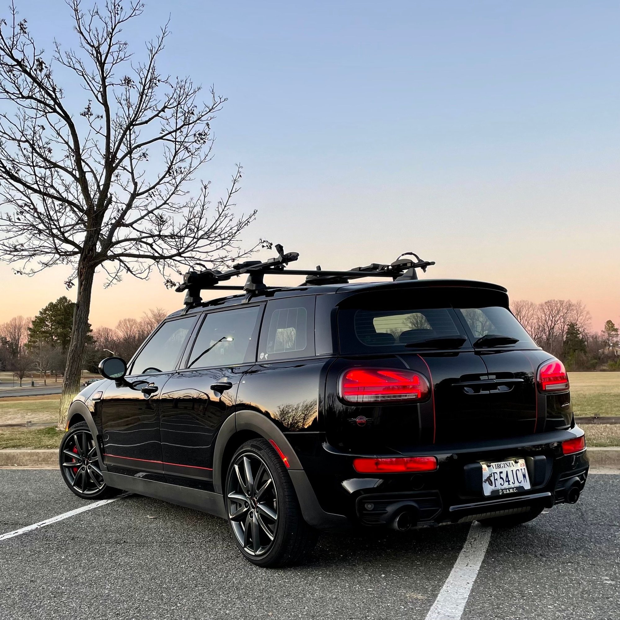

Another success!
Many thanks to @maaii (via @rfuller26 ) for the harness and excellent instructions! Another successful update to the UJ lights!! I am so in love with this look.
Sharp new UJ lights!
