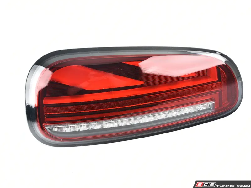

We have a set of the lights in stock again. Genuine MINI Black line F54 Clubman https://www.ecstuning.com/Search/Sit...CI_Black_Line/
We also have retrofit kits for aftermarket ones in Ziza lighting in Union jack
https://www.ecstuning.com/b-ziza-par...g-tail_lights/
