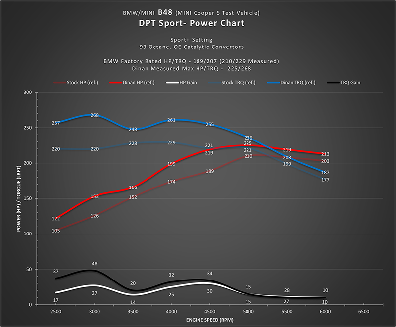

Back in fall of 2016 I had extensive conversations with people at NM and Dinan. Back then, the folks with whom I spoke at both places were great... back then. NM even invited me to come up to Camarillo and plug one in to take for a test drive!! And Dinan, at that time, was immediately responsive to my long list of questions.
I went with Dinan, thinking (incorrectly) that the Bluetooth feature would be something I'd use a lot. Reality has been that, after messing with the different settings, I landed on Sport+, which is the +3 psi setting it comes with from the factory. The 3 psi extra boost hits what, for the way these engines are programmed from BMW/MINI, is a sweet spot. No knock, no CEL's in over 18,000 miles, and consistent grins when my right foot gets heavy. I did run Race Mode when I was first experimenting (+4psi) and, on a hot day in a half hour of stop and go, I got a tiny bit of knock/hesitation. Dialed it back to +3psi and all has been well. 91 SoCal gas, always.
Installation is easy -- you just have to be mindful about the little gray clips that secure the plug to the sensor socket. And there are sharp edges in that neighborhood which did draw a wee bit of blood. But, if you are slow and methodical as I tend to be, half an hour and done. Skilled folks get it nailed faster than that.
Basically, these single sensor boxes trick the engine management system into thinking there's less boost, so the engine's computer adjusts and calls for more boost. The anti-knock sensors and fuel management algorithms programmed into the car from the factory adjust very quickly -- or so we're told. My experience has been that all of this magic works seamlessly with the box hooked up.
Only anxiety I had was warranty. My car is leased. I paid my $ and took my chances and it paid off richly. Only feedback I ever got from the dealer service people has been, "We gotta drive this to see how much more power you're getting." 2 different MINI dealers loved it. One commented favorably on my installation location..
And the extra power is noticeable, in every good way possible. Especially fun on hills and higher altitudes. Great in mid, greater still in sport. Never used Eco. After all, this is a MINI, right?
Easiest and most bang for the buck $300 mod available. ECS was great to deal with -- it was on sale when I snagged it around the holidays.

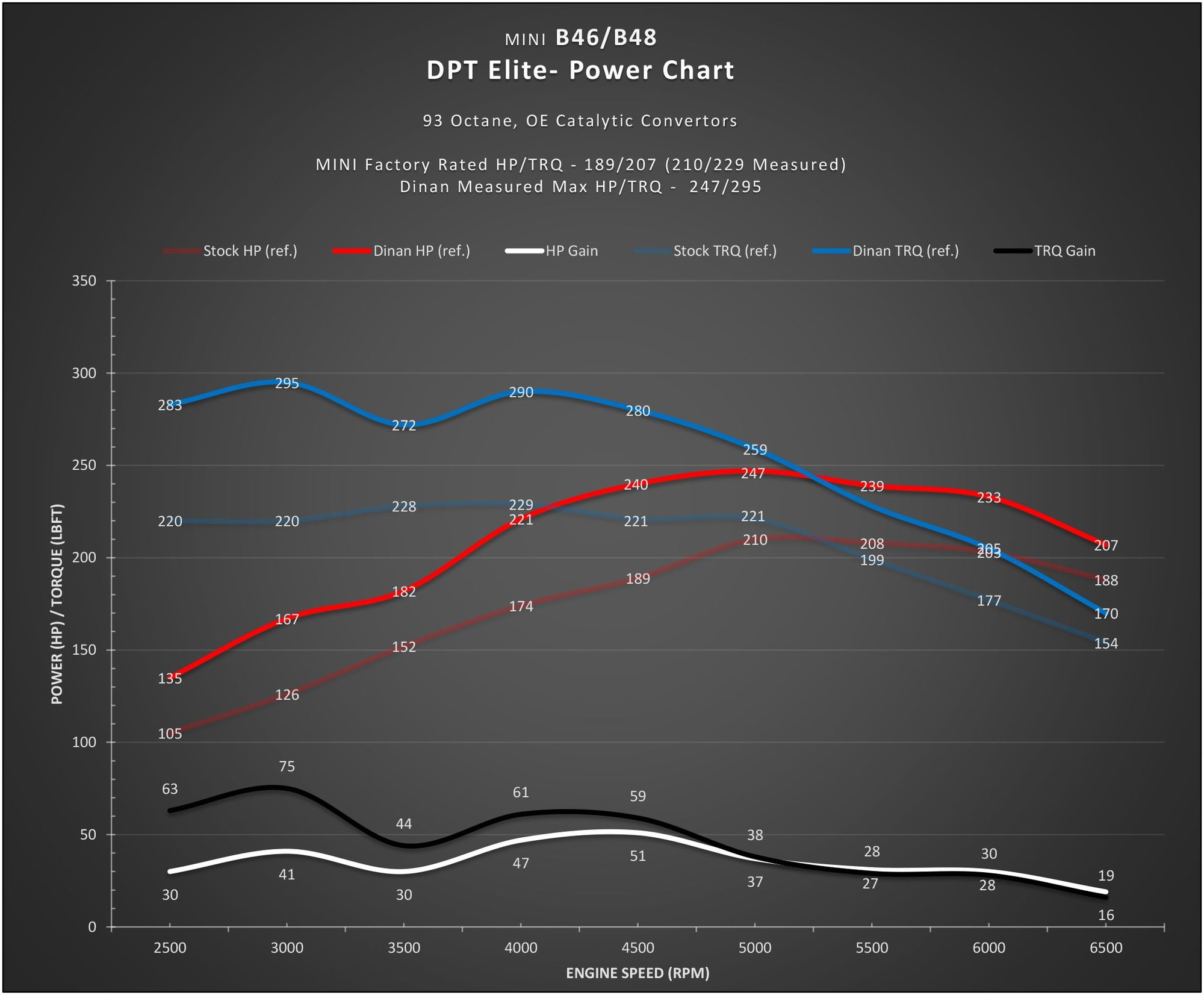

Many "graduated" when the Dinan Elite hit the market. Many felt the warranty shield with the Elite is worth the extra loot. Read the warranty carefully -- all it says is if a failure isn't MINI's fault then, under the regular MINI warranty period, Dinan will work it out with MINI, IF it can be shown that the Dinan caused the warranty issue. A lawyer's dream. A consumer's nightmare!! IMHO.
Some had issues with their Elites; some are still having issues and there have been reports that ever since Dinan relocated from California it isn't the same. If it runs as the specs say it should, the Elite is supposed to deliver more and smoother power. Some have reported this to be true for them. For me, the Sport has kept me satisfied. I plan to transfer it to my next MINI in a few months.
