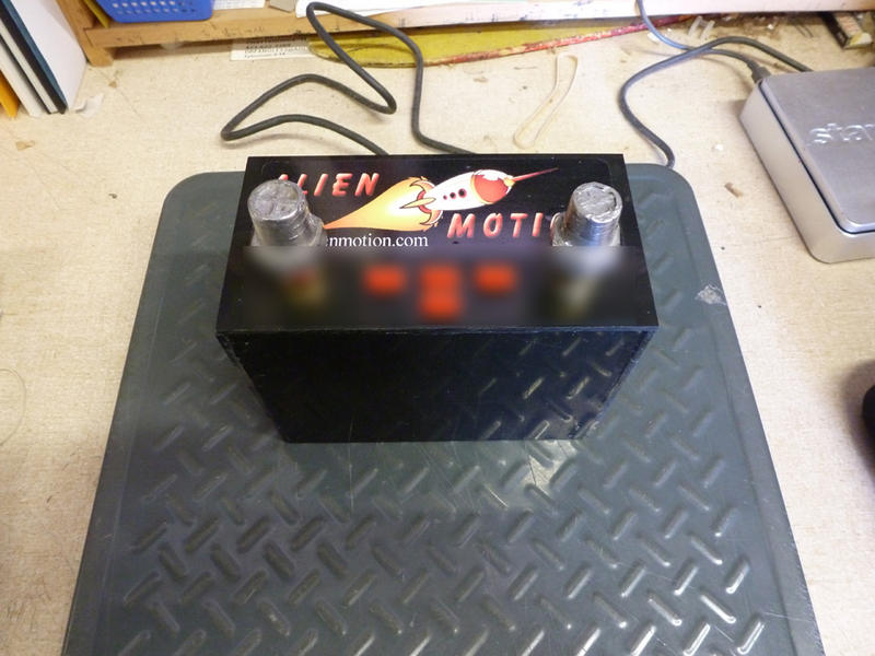

I just installed an alien motion battery in my car about a month ago. Since I have driven almost 3000 miles (hwy/city) with out any probs. It turns over much faster than the stock battery. I dont think they are producing them for general public sale yet.
Attached Thumbnails Lead-Acid to Li-Ion Battery Swap-batt_hd.jpg   Lead-Acid to Li-Ion Battery Swap-batt_hd_4lbs.jpg

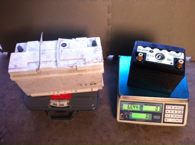

Old Oct 11, 2013 | 01:54 PM
Savage42's Avatar
Savage42
Joined: Oct 2013
Originally Posted by Yyrd
I was reviewing braille batteries, and found that that are re-badges of Deka's + 2-3 times the price so they can brag more.
I have a little experience/input/info that may help out in regards to the topics covered in this thread. I do know that it's a bit old and things have changed since these original post was put up, especially in regards to lithium batteries.
First, there should be clarification between companies that "rebadge" batteries and those that are contract manufactured for another company/brand by one of the large manufacturers. Johnson Controls makes nearly 20 brands including Optima, Die Hard and so on. They are not the same batteries, even though the same parent company. That being said, East Penn does make batteries for many companies and while they may come out of the same plant and use the same casing, the performance levels and QC can be significantly different. From my experience, the Deka batteries are what they are and you can check at the performance specs they have. The Braille variant is used heavily in racing and the performance levels and QC are much higher when being used in factory race cars. I know many custom bike builders who have a hard time starting their large bikes with the stock Harley battery, a Deka and absolutely no problem with the Braille unit and I've heard that several times. So, that is about it in that regard, but that is with AGM batteries.
Lithium batteries are new technology and are much superior than any lead battery. I have run a Braille B3121 (21 pound) battery in my wife's Mazda MPV for a couple years with great results. When I needed a new battery for my 2000 BMW 540i M-Sport 6-speed, I looked around for a lithium upgrade.
Last year at SEMA, Braille brought out a new lithium model designed specifically for the "Import Tuner" crowd, 4 & 6 cylinder street/track cars and even V8 race cars & hot rods with low electrical demand. The stock Group 49 battery in my 540i took a dump and decided to put one of these in it's place for several months now. It certainly has the cranking power, as it spins up my V8 much quicker than the stock battery. It is low in capacity, so you can't let the car sit for a long time without using the charger (recommend buying the combo). I did leave the car sitting for 9 days while out of town and had no problem starting right up when I got back. If I was going to be gone for more than 2 weeks, I would have used the charger. http://www.braillebattery.com/index....ies/gu1r_combo
Of course, my E39 540i does not have NAV or anything extra, so the parasitic draw would only be from the PCM and stock security system, so anything with more electronics on it may decrease the amount of time I'd let the car sit. In a daily drive, no problem at all. This would certainly be the case for the Mini owners out there to save 30-35 pounds.
I have pictures of both batteries side by side (attached), so I saved nearly 50 pounds and the car definitely runs better. Lithium delivers a higher, cleaner voltage, so it's common to see quicker starting, improved engine management performance, less horsepower draw from the alternator due to efficient charging (5 times faster than lead) and will last 3-5 times longer. The "drop-in" lithium model for the late model MCs is a Group 48, which bolts right in and at only 10 pounds it has more power & capacity than the GU1R, but also costs much more.
Anyway, that's my experience. I would probably go towards the larger version (in a new BMW 3/5/7 series) if my car wasn't 14 years old with 225k miles on it, but being older and not as much electrical demand from the car as the new cars, the GU1R seems to work well. It's a great option to consider and as an upgrade in older sports cars, as well. Hope that info is helpful. http://www.braillebattery.com/index....al_media_award
Attached Thumbnails Lead-Acid to Li-Ion Battery Swap-gu1r-1.jpg   Lead-Acid to Li-Ion Battery Swap-gu1r-2.jpg
