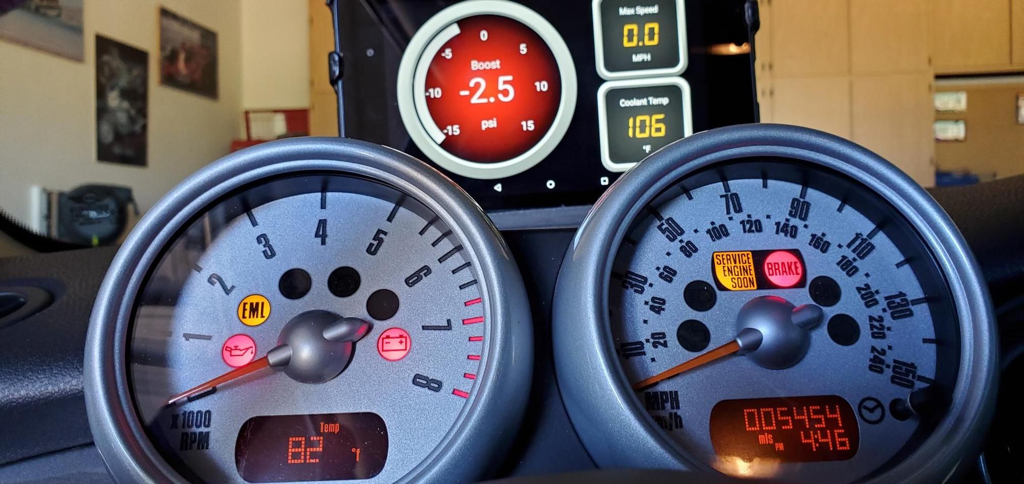

Since nobody has replied yet, seems to me numbers suggested should be at sea level as baseline. Images below show mine -2.5 psi at 5k' elev (displayed on Android tablet broadcast from BT OBD2 dongle with engine off) plus a related chart snagged off the web.

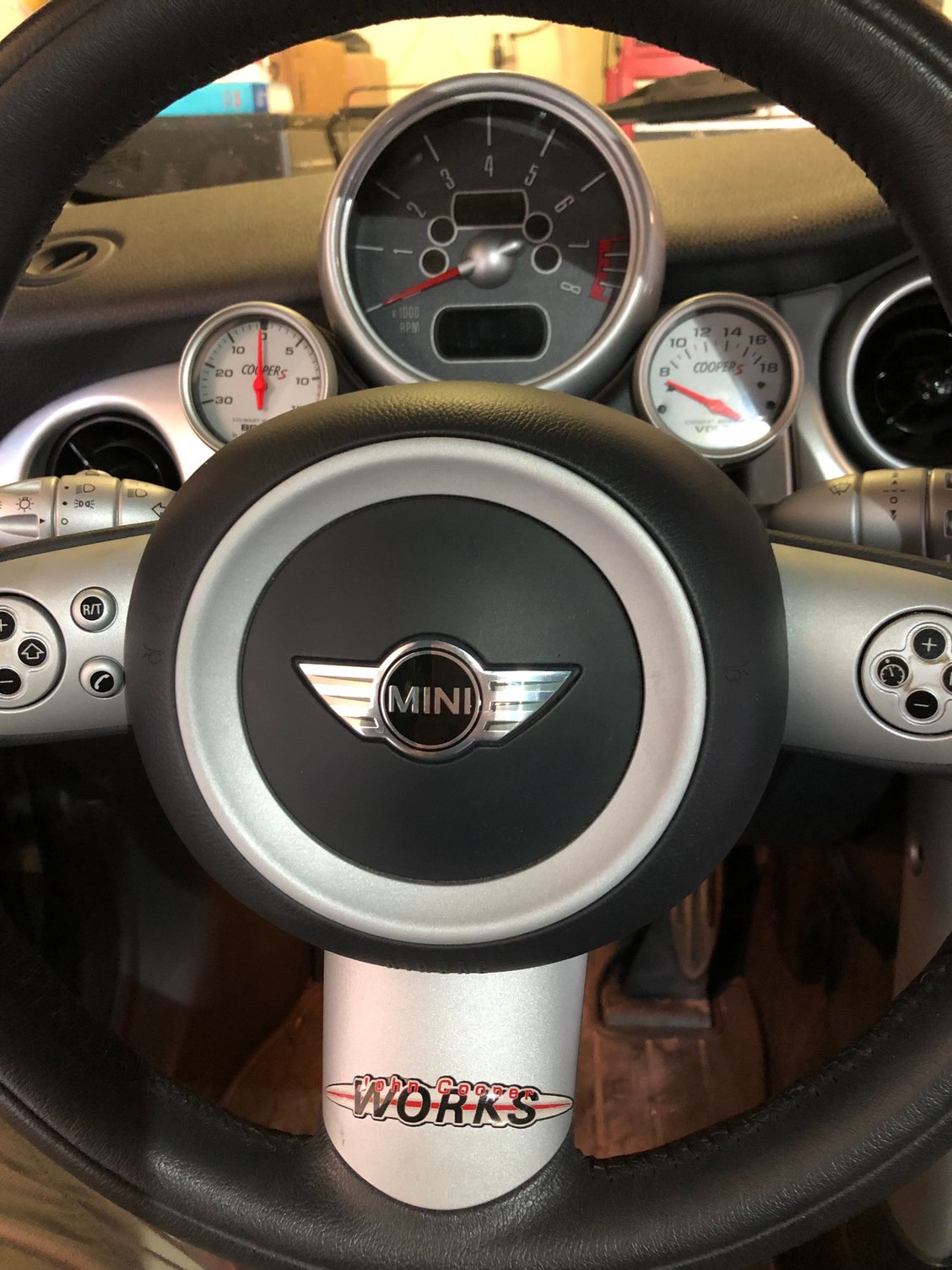

Using my OEM dealer installed boost gauge, I top out around 11-12 psi under hard acceleration.
My 06 GP with 69k miles is stock with no performance modifications.
It pulls hard but seems sluggish in first.
