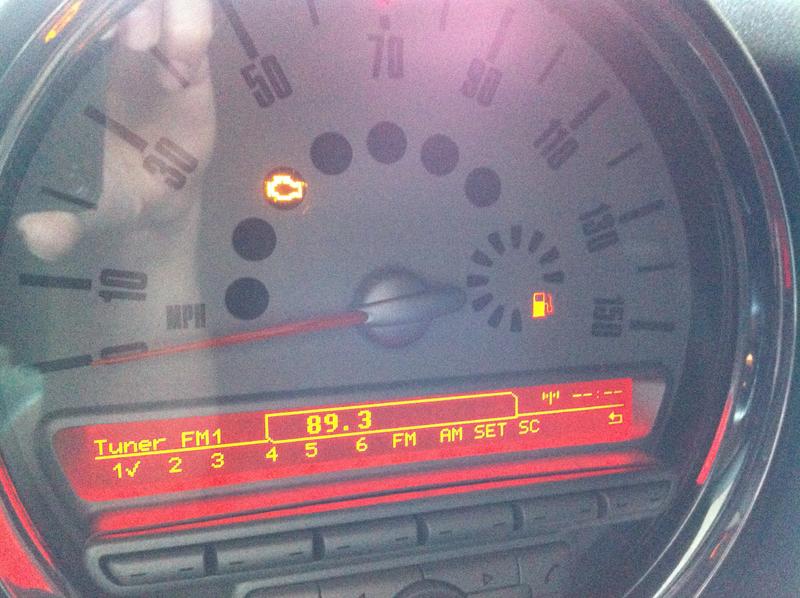

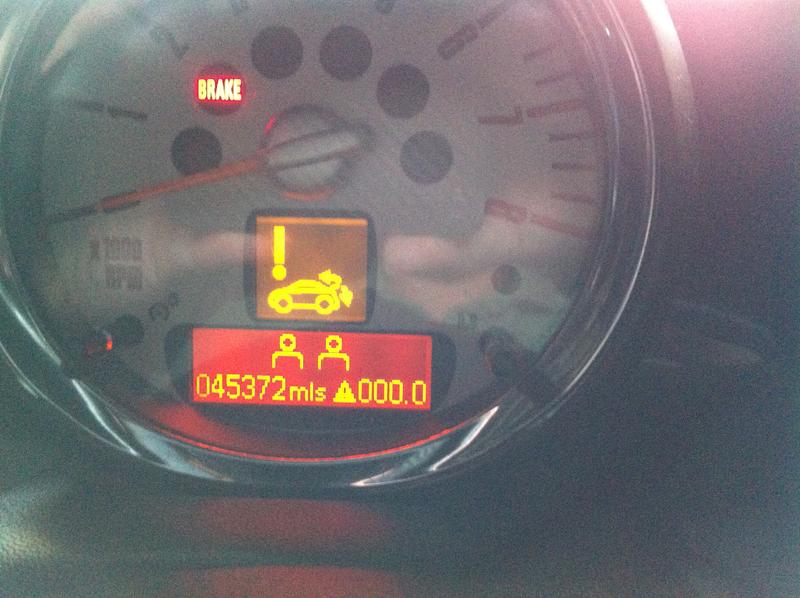

I just picked up my 08 MCS after having the cold start rattle fixed. I was coding in the kombi module, and now it thinks it is a coupe with the trunk open and the gas gauge doesn't work. The trunk open error never goes away, so I can't see any of the stalk activated menus. I have reset every module I can, but the error remains. Any idea how to make it think it is a hardtop again?

Check the vehicle order stored in the CAS and FRM modules. The model code should read MF73 for a 08 MCS hardtop, MS33 for a MCS cabrio (R57). If it is wrong, then change the VO and FA_WRITE or FA_SCHREIBEN to both CAS and FRM modules. Then you should recode all the modules back to default (blank file).
Keep in mind, the hardtop model was also named coupe by BMW engineering before the true coupe project started...
Juppers, As alexs3d2 stated, double-check the model in the VO. You can find the VO string in the FA.txt (I think that's what it was called) in the NCS Work directory.
Try to reset your KOMBI back to default.
1. Go into the profile editor and turn off trace file manipulation. Password to edit the profile is repxet
2. Then hit the Process CPU button (when you have the KOMBI selected).
Should take just a few seconds, but any changes you have made should be corrected and you will back to normal. Somehow you fed the module bad information in your coding attempt, either some settings got changed inadvertently or you ended up with the wrong coding level.
I have done this process a few times and what it does it "defaults" the module back to a factory defined state based on the vehicle order string. It has always worked for me.

I have already defaulted all the modules that I can read. Haven't had a chance to verify the VO string, but it is scary that it may have somehow changed itself.
The car runs, but no tach and no gas gauge. Definately seems like something wonky in kombi, but I have defaulted it several times with no change. The image below is why I said it thinks it is a coupe. See the weird trunk icon that won't go away.
Attached Thumbnails NCSExpert DIY(do it yourself)-img_0123.jpg   NCSExpert DIY(do it yourself)-img_0124.jpg

Oh boy. That's probably the alert for the spoiler of the coupé. Do you have your original trace backup? Program that in if you have it.
