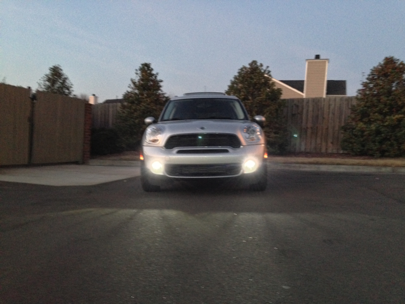

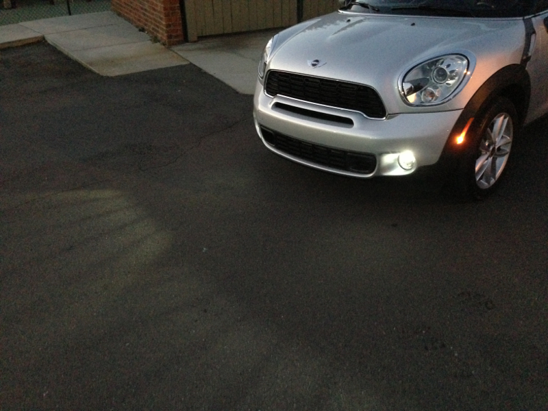

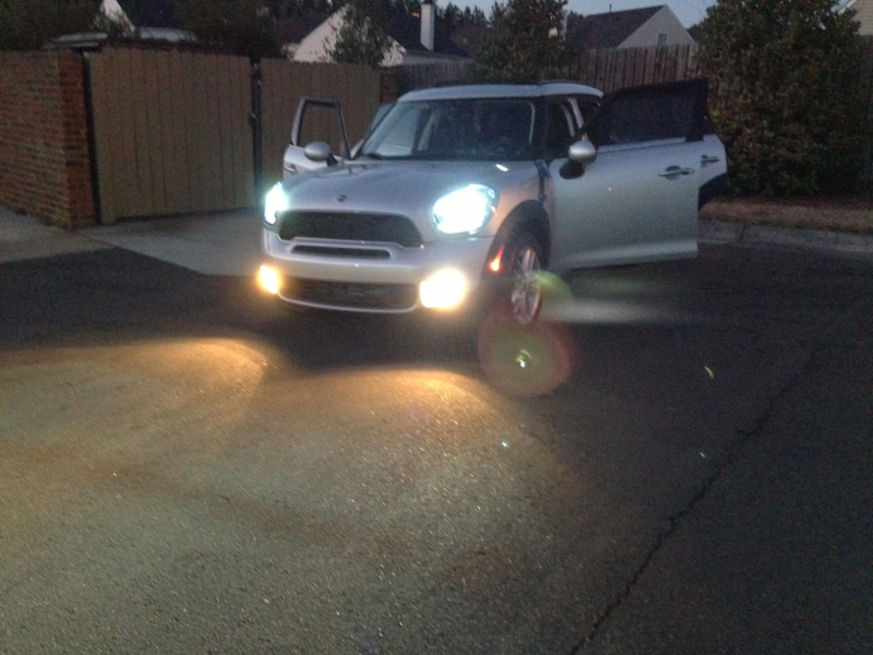

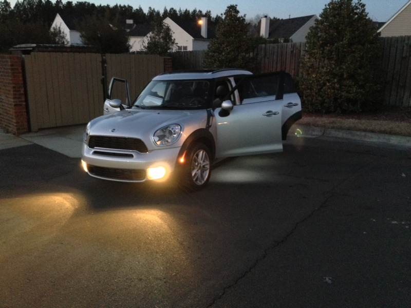

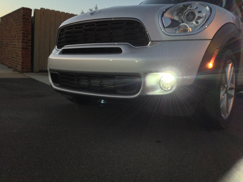

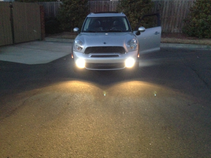

Some pics (iphone 5, I'll snap some with my DSLR later)
Attached Thumbnails LED Bulbs-image-1990895710.jpg   LED Bulbs-image-41255937.jpg   LED Bulbs-image-3549904504.jpg   LED Bulbs-image-815530034.jpg   LED Bulbs-image-433533800.jpg
