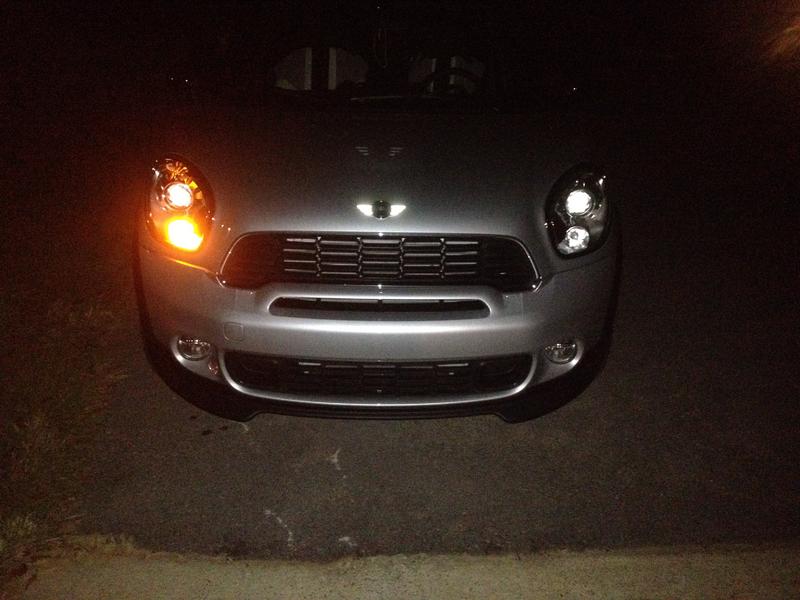

Cree XPE single LED Parking lights and OEM xenons lit:
Cree XPE single LED Parking lights, Nokya Yellow Fogs lights, ans OEM xenons lit:

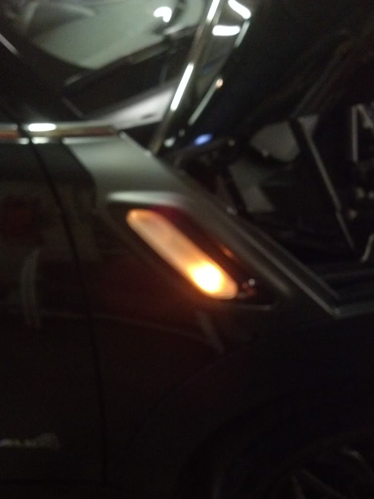

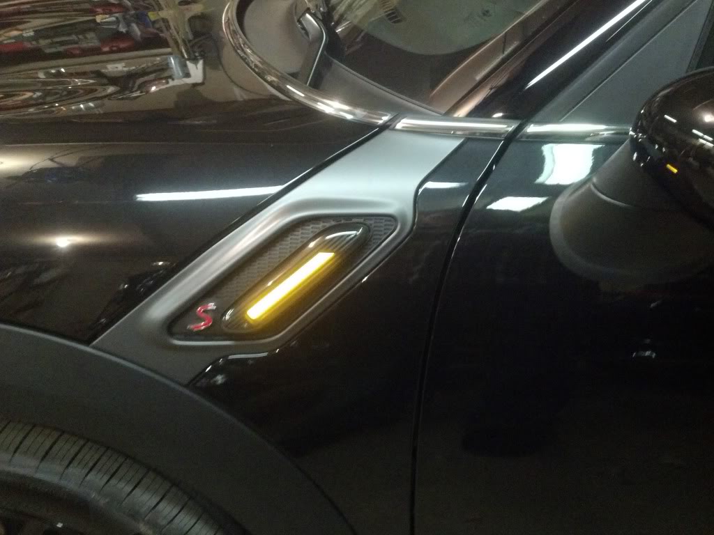

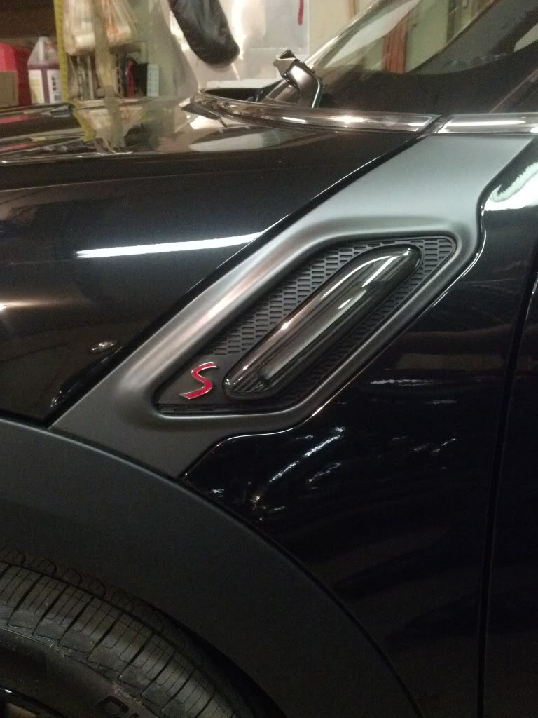

Here is the before and after. I think they look awesome!
wow those are nice.
