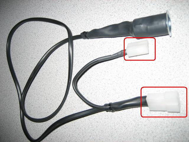

Does anybody know which plugs they are using?
