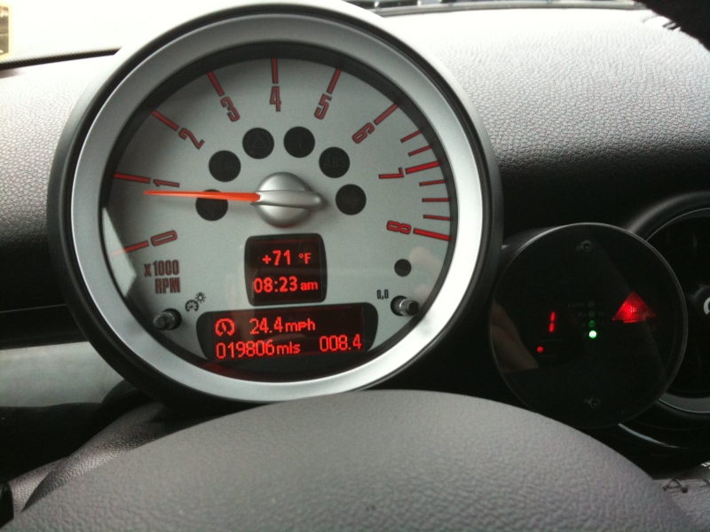

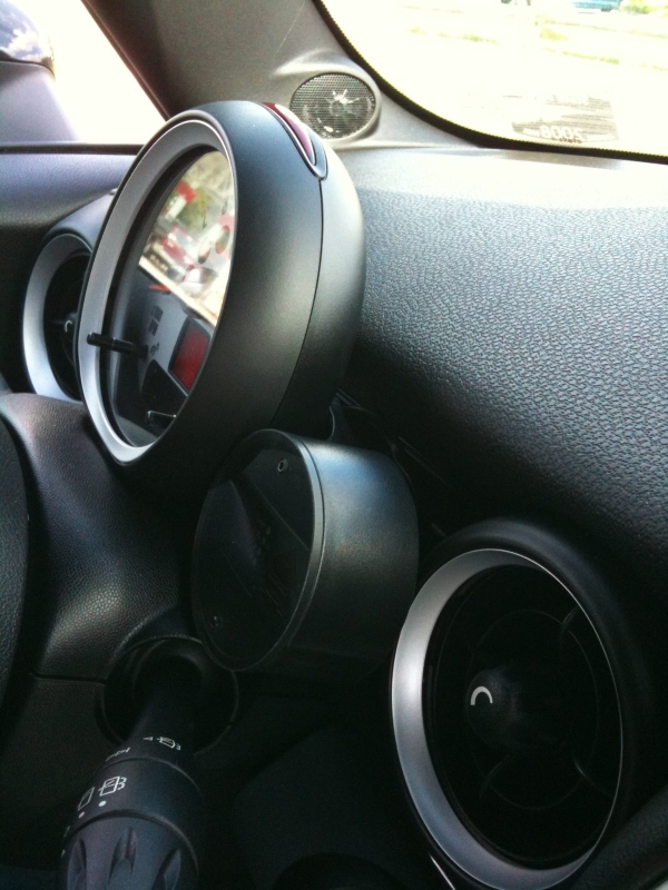

So after starting this thread (and project) over a year ago, I finally completed the remote display gauge pod. I used an Alta gauge pod and modified the V1 remote display with different colored LED's. Everything else inside the gauge pod is custom along with an extra RJ port so I can connect a mute button.

looks great. my only question is does the steering wheel block your view while driving?
either way good job!

The steering wheel doesn't block my view normally. It's only blocked when I have the wheel turned so far that one of the spokes blocks it or when my right hand is at 1 o'clock.
Now it's easy for me to see the arrows and colors using my peripheral vision compared to looking at the main unit above the mirror.
