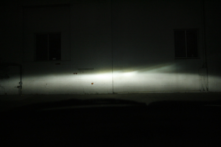

Here's my story, and I would like all who have done this to add to this thread.
1. Halogen
2. 03 MC
3. 04 Xenons (OEM).
4. Washers / no auto levelers (manual leveling controls)
RESULTS - Plug and play. Worked w/ no problems.
Comments - I was given D2S bulbs, instead of d2R, so the cutoff is undefined and the glare is not great.
Here are some pics
Attached Thumbnails The OEM Halogens ---> OEM Xenons diaries-_mik6479.jpg   The OEM Halogens ---> OEM Xenons diaries-_mik6475.jpg   The OEM Halogens ---> OEM Xenons diaries-_mik6531.jpg
