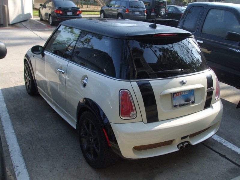

Originally Posted by chaseabryant
ME: 2003 MCS (Build date 10/02) Factory Xenon
Switched to: 2005 Xenons
NO trip to dealer, done at home, didn't even un-plug my battery.
Yes, yes, and yes. Now, I will say that I used the washers that came with my car, as the person who was selling the '05's didn't include their washers. The washers snapped on just as they should, and there are no fit issues to speak of.
Levelers also work just as they should, upon turning the headlights on, they do their little up-tip, just like my original Xenons.
So, from somebody first-hand, a switch from a pre-04 xenon equipped car to a set of '05+ Xenons does work without a flash.
Here are a few pictures!
p.s. I have grille trim from a 2005 on my car, so don't let that throw you off...
-Chase

6FT6
Joined: Jan 2010
Posts: 322
Likes: 53
Gents and gals, I've been reading a lot of the info presented in this forum and I must say I have learned a lot about the cooper. I'm a first time owner of the Mini Cooper S and so far I am very pleased with the "fun factor" and nostalgia experienced with the car.
I recently moved to Houston on assignment from the Caribbean (yes we drive from the right side) where there are lots of Austin Minis and bought an 05 MCS. Now based on what burley has established in this thread, I cannot retrofit my 05+halogens with 05+ OEM Xenons.
However in another thread it states I can once I acquire a harness that would connect to the battery thus eliminating the CPU flash.
Now I called the dealership and they informed me that they cannot do the retrofit, they tried before and it doesnt work...they did suggest I just get brighter bulbs tho.
Will I ever be able to get HIDs in my beloved MCS? I like the look of the aftermarket projector units, but I know Ill be most upset with the results based on what I've read so far.
Can anyone share some insight?
Sorry for the long post.
