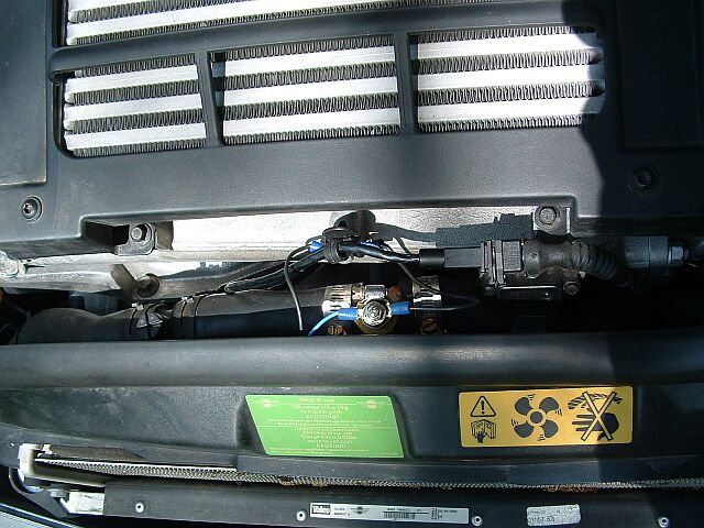

Here's the coolant sender:

Could you elaborate on where and how the senders are attached exactly?

The oil pressure sender is installed into a modified stock oil filter housing.
The coolant temperature sender is installed into a gauge adapter like the Inline Temperature Gauge adapter found here:
http://www.pegasusautoracing.com/pdfs/037.pdf
