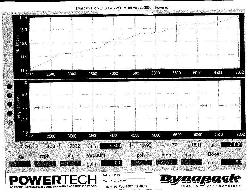

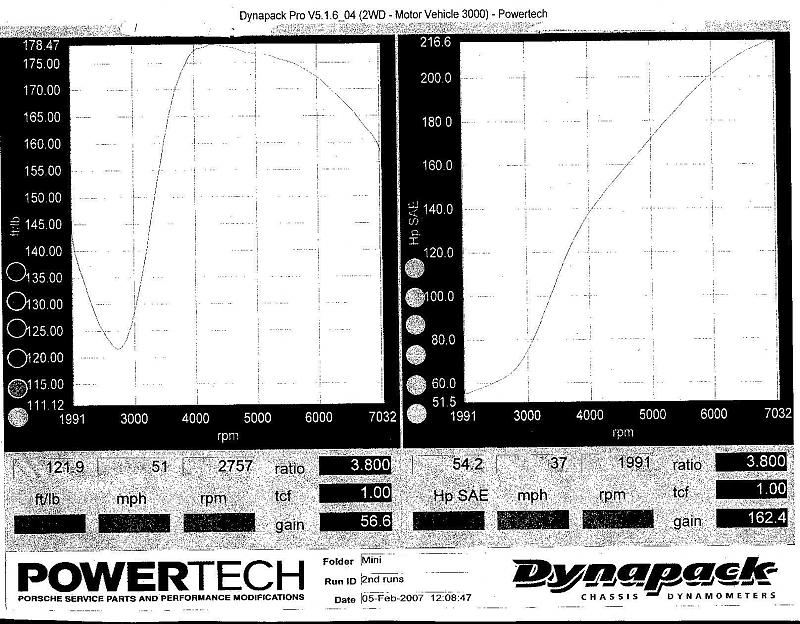

Originally Posted by dmh
I just started to use the Dynapack at PowerTech in Rockaway, NJ. Mike and Keith are the owners and interestingly they used to work with Randy Webb at Promotion Motorsports in Morristown, NJ.
Today’s numbers: 216.6 WHP; 178.5 ft/lb torque
2005 MCS, CAI, 19% pulley, matched intake runner, DMH cylinder head +1/+1, Schrick cam, Borla cat back, custom tuning.
Temperature: 64 deg F
Humidity: 21%
Barometric pressure: 29.50 in-Hg
IAT: 148 deg F
Water temp: 202 deg F
Oil temp: 205 deg F
5W-30 Mobile 1
4th gear
Stock gearbox fluid
93 octane
Well here are the sheets and and all i can say is WOW! Great Job Don
Just check out that boost with the 19%

I heard that The reason I did not post is that it is not my company or place to post.... I personally don't care..... now that I have posted I will keep you up on developments..... there is hope for the 62.... we have not gotten it there but apparently Don has...... congrats.....
who knows what the "gain" number mean in the Dynopack.....

I have the same exact type of upgrades acept for a 15% pulley along with Nology wires, NGK spark plugs, throttle body, an M7 OCC along with custom tunning.
Want to get a dyno but with so many here having similar to exact uppgrades as mine it pretty much tells me what kind of power my car is putting out.

Except that car has the MTH and on top of that the Perfect Power ecu kit, probably tuned on a dyno and on the road.
