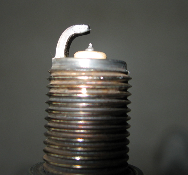

~15K miles on my IK22s. Pulled them today for a torque and gap check. I'm thinking they don't quite look like they should.
Found a web pic of what I remember them looking like and have posted a pic of what they do look like.
I'm thinking there's a bit of anode missing.
All 4 look like this. I'm also thinking that's a bit more than the proper gap.
Not hugely impressed right now.

It does appear as if you have some abnormal wear for only 15,000 miles. I would be curious to see what plugs of others running IK22s for around 15,000 miles look like. I hope someone else posts pictures. I am thinking maybe I will hold off going with the IK22s on a pulley upgrade project unless I have drivability problems.

Didn't do a visual last time just a torque check so it's been quite a while since I looked at them.
Car still runs well though. MIght be the beefier coil is helping here.

Yep. I'm not particularly hard on the car and my commute os <5 miles one way in slow traffic.
Car still runs well though. MIght be the beefier coil [Emphasis added.] is helping here.

Here is an IK22 plug, also after 15K mi. It does look as if yours has worn away more than this one. However, I agree with Ryephile, the Denso plugs don't last too long.
Thanks.
My car has been pretty well cared for and never had any real heat issues.
Think I'll try to get some before/after timing retard data.

Interested in the photo of your IK-22 spark plug after 15K+ miles. Looks exactly like my IK-24's after 15K miles. The center electrode appears eroded and the gap is opened up to 0.040" or 0.042". I'd characterize this wear pattern as normal and expected.
A couple of points: 1) The fine wire electrode of the Densos would be expected to erode twice as fast as the twice as large NGK center electrode.
2) The erosion rate has nothing, repeat "nothing", to do with the coil pack characteristics. The aftermarket coil packs are essentially the same, as far as electrode erosion is concerned, as the stock pack, despite what you might think. There are ignition systems that will increase electrode erosion, but not this system.
3) The stock MINI ignition system was designed to fire an electrode gap of about 0.062". Great for the street - starting, MPG, emissions - but falls far short on pulleyed cars at high RPM's. Most tuners run the Densos and NGK's at the out of the box 0.032" and call it good. So, the electrode opening up to 0.042", by itself, doesn't hurt ignition performance. That said, increased electrode gap, erosion and rounding of the electrode surface, and even minimal insulator deposits after significant mileage (even if the deposits don't "look" very extensive) do lead to misfire and the need to replace the spark plug and start over.
4) Read this SAE paper on iridium electrode spark plugs, if you already haven't, from sparkplugs.com. Lots of engineering data free of the claims and myths that haunt all knowledge: http://www.sparkplugs.com/pdfs/iri.pdf
If I was a performance oriented MINI owner, changing spark plugs every 20K miles or more often, wouldn't cause me a moments hesitation. If I were a vendor selling products and my customers are comparing my product with claims by the manufacturer and other vendors, I'd opt for what some might consider the safest approach. At least the customers won't complain to me.
The bottom line, your plugs look fine to me after 15K+ miles. I'd consider IK-24's for high output conditions, and I'd plan on replacing my spark plugs every 15K to 20K anyway. I'm very happy with the performance of the Denso's and love any opportunity to twist a wrench on MINI.

Thanks John. I may have mislead you on the coil issue. All I meant was that the higher output coil will bridge the larger gap easier and thus has less of an impact. IE misfires. The car runs fine.
I was digging through sparkplugs.com yesterday and that
is how I finally found a cross reference for the IK24 to NGK. Stuck with the Denso anyway.
It's becoming pretty evident now that this is "normal" as far as the Iridiiums go. That's fine and the frequent changes aren't really an issue. I've never let plugs run more than 25K anyway.(Well maybe in my minivan
)When I first ran the IK20s pre-pulley I ran them gapped at .042. minimc and I had played around with gap. He found that at ~.060 he had issues. I really don't remember if he was running a stock coil or not.
The old MSD 6AL would eat up plugs nicely. Worth every penny of it though.

Steve, fine on your plug experiments. Ethanol is probably coming our way soon. I don't have the slightest idea how to tune for it. What do you know? And, what do you recommend? Hope that the link helps.
Obehave, as always, good talk to you. I did misunderstand. I agree 150% on your aftermarket coil with the larger available voltage will absolutely reduce the risk of misfire with worn plugs. Right on. I think that that modest increase in available voltage from the aftermarket coils is their greatest asset. Your never going to see that advanatage except when running either worn plugs or if you experiment with larger plug gaps. I was running the MSD DIS II system for awhile and was experimenting with plug gaps up to 0.080". Car ran great with new plugs, but started missing in high output situations. Eventually reduced the gap on the IK-24's to the out-of-box settings and had no further problems. Idle and cold start were much, much improved with the MSD. But, your comment about the multi-spark CD systems eating plugs was true as well. The reason is that any CD system provides a spark characterized by very fast onset (short rise time), short duration spark with massive current (for that short period). Hell on electrodes, that massive current. The latest F-1 ignition systems have a hybrid ignition system that provides an initial single CD spark followed by a true "plasma", or long duration inductive type sustaining spark. Also, the spark plugs are connected to a sophisticated combustion chamber monitoring system that provides feedback to the overall engine management system.

"The old MSD 6AL would eat up plugs nicely. Worth every penny of it though.
" Still have 1 in my Spitfire & it will burn the arm & electrode right off.
Obe, did you get some IK24's to run yet?
"Steve, fine on your plug experiments. Ethanol is probably coming our way soon. I don't have the slightest idea how to tune for it. What do you know? And, what do you recommend? Hope that the link helps."
John, are you running the IK24s with the out of the box gap? Not that this is an important factor, just curious, I took mine out of the box and installed them. Right now it's too early to tell how the Ik24s will work. I'm using Nology wires & a stock IGN. Starting from cold, gas mileage, SOP performance all feel better with the new fuel mandate. This could be just new plugs, but the old 22s looked pretty good. I would know more if I could measure the EGT, then read the plugs. When we ( my son & I ) were racing shifters & 2 cycle pipe karts, we could make good choices for the plugs that we would use. Without any fuel management we could make adjustments based on reading the plugs. The IK24s just need a couple K more & I'll take a look & see how they look.
" Still have 1 in my Spitfire & it will burn the arm & electrode right off.Obe, did you get some IK24's to run yet?
when Randy put these in at pulley install , he told me they should last 100K .I looked at them at 22k after install and this is what they looked like(sorry for focus issue, my camera doesn't have a macro setting, but you get the general idea) I have 2 sets, one in the car and another in reserve that I got way back when, and when they are gone I'll try the NGK's . I check them often........I'm NOT a big fan.When they work, they work well, but...................
(ik22)
(ik22)
