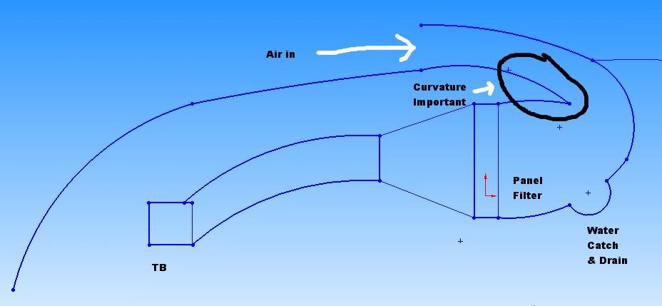

This is very rough, but it illustrates the idea, I think, for the ram scoop.

Will, are you saying that the curvature is important because it shouldn't be as "hard" as your illustration shows?
Pro to type... pro to type.... pro to type......
Not exactly. It needs to be experimented with for a variety of reasons. First, you are going to have that lower section behave like the top of a wing. The curvature and angle of a wing is very important. Too shallow a curve, and you will have separation. Too steep and you have separation. So you can't have a change of angle more than 10 degrees over a length. of course, that length depends on speed, so I'd say figure out the best curvature for 70 MPH, and it should have a good amount of coverage for average speeds. Obvioulsy change it for a race car, etc.
But it NEEDS to curve. If it's flat, the air will not turn correctly when it hits the rear of the intake, and you'll get a lot of backpressure. But if you use that surface to draw the air into turning, then you'll get it turning and spinning before it hits the curved back wall, and it will ram 180 degrees back and through the filter.
From a plan or top view, do the side walls also have to be curved or can they stay flat for ease of fabrication. Also will the water trap as you describe also change the flow going into the filter? Finally is better to fab as large as a box as possible (volume)
Side walls can be flat. If possible, filet the corners to avoid sharp corners, they'll trap flow. The water trap at the bottom is like a cup, and it doesn't need to be as large as I've shown it. It's mostly there to catch the water that will be running down the back wall. You'd make a few small holes, maybe 1/8th inch, maybe 4 of them, and probably use a hose to drain the water all the way out the bottom. Volume of the chamber is good, the more you have, the better it'll be at pressurizing.

3.25 inches is plenty high, and there are ways you can make it better. But how wide is it?
