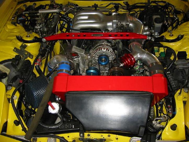

Thought I'd spice things up with a little pic of my other cars IC. I'm a newbie to this list be gentle...
I didn't realize they made IC's so small till I got the Mini. Here is a pic of my 93RX-7 engine bay IC (it's the big red thing :-)) it's about 14inch tall/3inch thick. I recently clicked off 117mph 1/4 in 12sec on street tires. Racelogic traction control, water injected, to many mods to list. It puts a dynoed 360hp to the wheels...not the fastest rx7 around but it runs real good. Its probably getting a new turbo for its birthday. See if you can pick out the diet mountain dew oil catch can :-)
Anyways I bought/love the mini 2006/jcw/royal grey end of last year and have bought most of the non engine related parts from m7 (get some pics up soon) sells, braces, splitter, grills, springs etc. He seems like a good guy and you can actually talk to him if needed. Being a small busy business owner I respect that.
I'm still hedging a little on his IC till I see some more #'s, but from talking to him personally it sounded great. Having two performance cars to buy parts for I have to be somewhat reasonable. I'm a little suprised as long as it sounds like its been worked on that they don't have more hard real life data that compares their ic to a stocker that would shut all of this up.

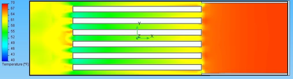

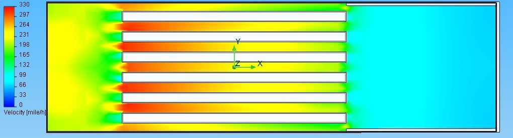

Here are a few plots from the design stage when we were doing our CFD tests. One thing to note is that I don't expect the intercooler to perform exactly like the plots show. If I got everything close to right, it should be close, but the numbers will tell the tale. So before anyone goes ballistic on us, these are showing a general behavior, not an exact performance of the DFIC, but may help to explain what may happen with this intercooler. Also, the turbolator fins are included in the calculation, I just suppressed them for the pictures because they blocked the view.
The setup for these plots has the car driving at exactly 70 MPH from left to right, at sea level (1 ATM pressure) with an ambient temp of spproximately 68.5 degrees F. You're only seeing the air flowing through the cooling side, with the scoop to the right and the exit to the left.

The velocity map is very cool.
The air comes in at 70 mph, and ends up at over 300 mph on exit! Certainly not a condition you will find with the stock intercooler besed on the flow geometry. I don't know if the air will really go that fast, but it will certainly speed up with any kind of pressure drop close to what the sims predict.
And now for the temperature plot. This should help to explain what we have seen, and the legendary 100%+ efficiency calculation. Once again, no we are not claiming to exceed 100% thermal efficiency, and we'll have to wait for Matt's testing to make any claims on efficiency at all. However, possiblities exist, apparently. As you would expect, as the pressure builds up in front of the scoop, the temperature will also rise, which it does be about 2 degrees F. Remeber that the volume is very large in front of the scoop, and it's constantly being fed 68.5 degree air at 70 mph. So the pressure drops as the air moves through the core and speeds up, and with any pressure drop there is a resulting temperature drop. How much? Well, the sim says about 20 degrees by the exit.
The average temperature inside the core is about 55 degrees F, which is lower than the ambient 68.5 degrees F. An interesting result, to say the least. If this is correct, then the data that we have shown could, in fact, be correct. It's not that we are exceeding 100% thermal efficiency, but that the caculation uses an incorrect value for the ambient temperature measurement, since the effective temperature of the cooling air could be as low as 50 degrees. Not saying that it will work like this, but the possibility seems to exist. So we're not violating any laws of physics, just using them creatively.
It's going to be interesting to be sure.
