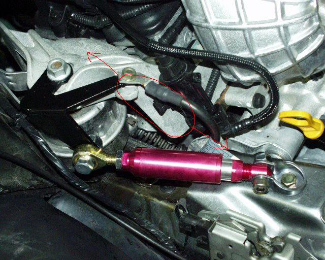

Need advice mounting engine damper on 2005 S
I was looking through the various posts on engine dampers and the only photo I could find of a 2005 engine damper had a wimpy looking bracket and was mounted at like 25 degrees off-center from the force of the engine rocking. I'd like to do something a little closer to the 2002-3 engine mount style which is mounted in line with the force of the engine. For those who know welding, how feasible would it be to weld a bracket to the engine cradle as indicated in the attached photo of the 2005-style mount?
1FSTMINI, you have an 05... did you end up installing an engine damper?
Also, for those who have a 2005 S, are there powerflex engine mount bushings that fit the new mount style?
Attached Thumbnails Motor mounts?-2003-engine-damper.jpg   Motor mounts?-2005-engine-damper.jpg

Here's the solution for '05/'06 engine mount slop:
It works so well, I can feel gobs of vibration in my seat at idle!

Thanks, gandini. Is it welded to the cradle?
I plan to get the Stiffy (build by Ingalls Engineering), which has an adjustable preload, in hopes that I'll be able to adjust the damping resistance vs. vibration level to my liking. If anyone out there has a Stiffy, perhaps they can comment on how effective adjusting the preload actually is...

The brackets are 2" angle iron, which was available and I could work it without having to weld (I don't have that facility.) The top bracket is fitted to the motor mount and is possibly the "weakest" link--time will tell if the 8mm diameter bolt that holds the earth strap is sufficiently big enough for the loads. The frame bracket uses 2 12mm bolts and is pretty sturdy, with all the forces working in the right direction. The NRG damper unit is the same as the Ingalls unit.
cheers,

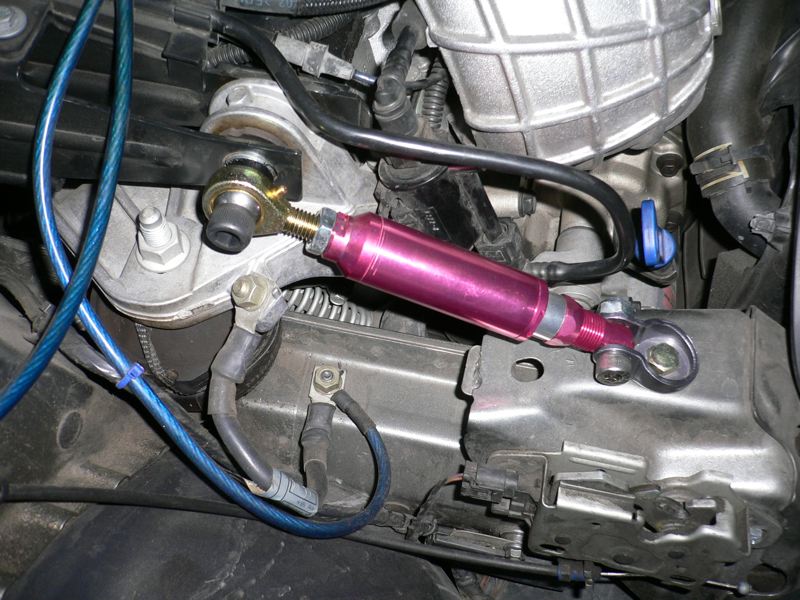

I mounted one without any brackets...

Partsman,
Where did you get your dampener? Is there a hole in the block that you mounted to? Did you have to drill a hole in the frame to attach to as well on the other side of the dampener? I have a catch can in the area that most guys are mounting these dampeners and I like it that you set it up the way you do.
