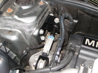

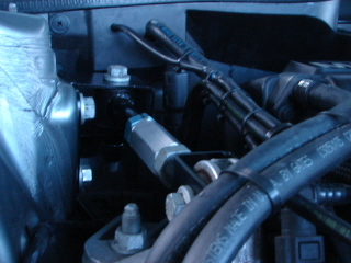

Discovered that my upper motor mount rubber was dry rotten and torn, so I decided to eliminate it all together. Not happy with changing parts with the same parts. I made a new one. Its very rigid, no movement at all. A slight vibration just off idle but nothing anoying. Shifts solid, both up and down. Steering is more controlled. It is also adjustable for preload.
Attached Thumbnails Motor mounts?-motor-mount-1.jpg   Motor mounts?-motor-mount-2.jpg

lambspeed, why are ur strut tower botls so rusted??

If you had seen the strut brace I made, It had cups where the nuts went in and water would sit in them. Just never cared enough to change them.
Do you have bigger pics? close-ups?

From: Forked River, NJ
I have exhausted my upload capacity. If you want bigger pics I can email them to you. PM me with your address
got it!
__NiCE damper BTW
