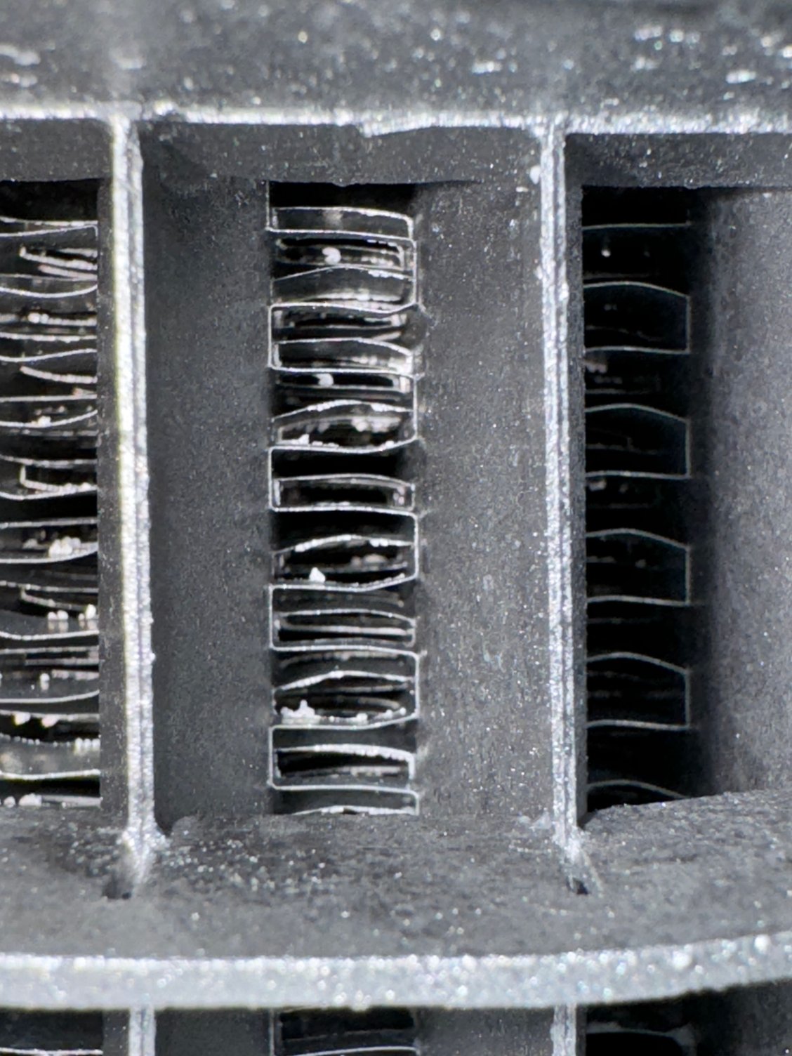

Nissens GP intercooler have recently became available for a very good price. Picked up today from a store and I was really dissapointed in quality. Just look at this photo. There are pieces of metal left over after cutting process. Doesn't look normal to me.

Can you pop one open and look inside?
I'm curious if the ones that look like they were punched out by dull equipment, if those are knock offs?
With all those bits of metal "hanging chad" - they look randomly left behind, I'm sure the intent was for them not to be there - meaning they would each be concerningly held on in inconsistent 'almost-cut-off' way. Almost certainly at least some will surely come loose over time with airflow and vibration and age, given how they ended up - from a process that intended to cut them off entirely..
Are the REAL Nissen a high quality made with first-rate equipment? Are the two in this week's recent forum threads both knock offs?
It's a troubling picture.

I am just wondering if this was purchased directly from a reputable parts place for minis or was it off a site like ebay ?
