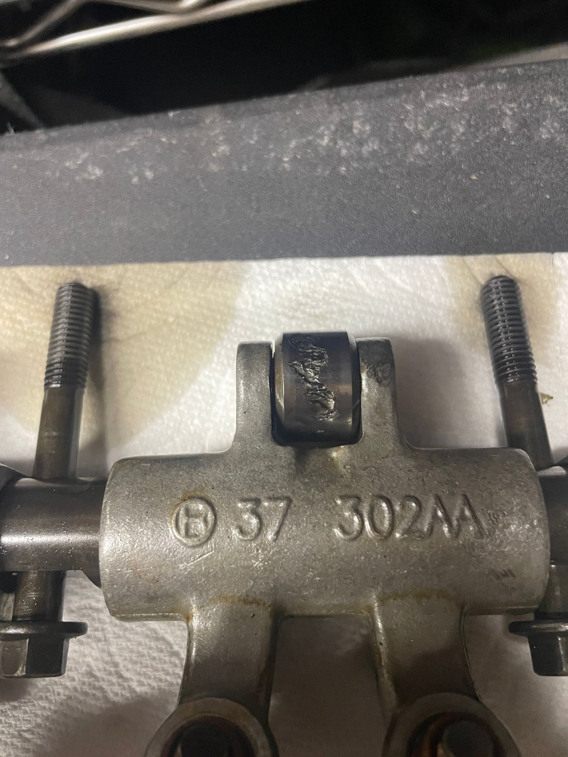

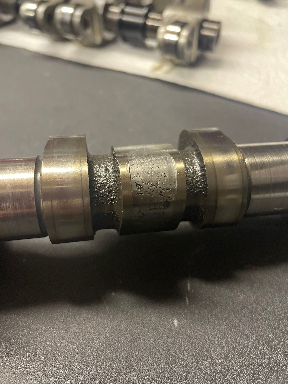

I attached photos of the cam and roller. Im not trying to say it was rmws fault, because there isn’t any way to tell for sure. What I do know is that everything else in the head looks good. The car had bigger valves and a built head according to the last owner. However when I talked to Jan he said it looked like a stock head. I measured the valves and they are over sized, but I think the springs are stock. It looks like there is some light porting done. The car also had a rmw newman cam, which I’m not sure if it needs different springs which could have contributed to the problem. I also am wondering if the Newman cam was why there was the lash caps and if I need to keep them for my cat cam 469?

When I replaced the valve cover on my last engine at about 150k miles a few years ago, I found cylinder 1 exhaust cam lobe looking like in your picture and its roller galled slightly - not nearly as much as in your picture. That was stock everything. It seems to be a known thing that R53 cams will show this sort of wear in spite of proper oil change intervals.

I'm thinking that may have been one of the bad Cam Blanks that were floating around a few years ago, (I can remember which company had them) and the Cam is what wiped out the roller, not the other way around (since the roller doesn't appear to have seized or flattened, but is trashed all the way around)

Honestly, with the condition of the Cam and Rocker/Roller, I'd at least pull, inspect and/or replace the Rod Bearings, that's a lot of fine metal to have gone through your oiling system, basically cheap PM at this point.
