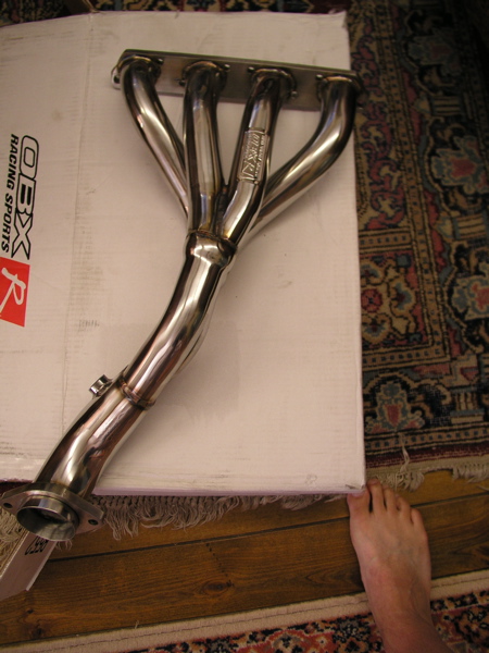

I called JetHot and got a quote for $150 plus shipping. I had it done on a 428 CJ motor and no problems so far. I went with what worked before. I just need to figure out the cat part. If there is no benefit of changing over stock or marginal gain, I'll stick with that, but the stainless to mild steel issue is something that concerns me. I had a failure on a joint on another car, I'm sticking with all the same material somehow.
Keep the faith.

Looks good....I meant the header, not your foot.
I think im going to do that myself....Good stuff. ....I know this prob has been debated b4 but, is there any difference with or without a cat?
