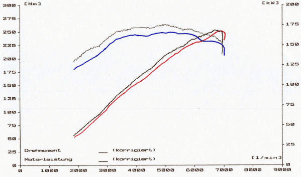

Here are my dyno numbers with the obx-racing headers installed. We used the oem-kat, please notice the before run was at 28°C and the after run was at 56°C!
My configuration: 2003 MCS, 56,5mm pully, mth ecu, beru spakplugs, k+n CAI and remus exhaust.

Nice gains across the board there And with twice the ambient temp.. EVEN BETTER When you say you used the OE cat, you had it welded on? Do you have any pics of this system??

It's nice to see real data!

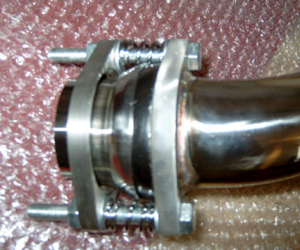

Yes we had to cut the oem header and weld on the cat to an connection tube.
I have the OBX header from sparktec on ebay.com for only $ 175,- !
Here are some pics of the header:
Attached Thumbnails OBX-Racing Header Dyno Results!-obx-seite-komplett.jpg   OBX-Racing Header Dyno Results!-obs-anschlussplatte.jpg   OBX-Racing Header Dyno Results!-obx-verbindung.jpg

I'm surprised to see about 10 Nt-M torque gain so uniformly across the rpm band; I would have expected to see some peaking behaviour from the header tune. I suppose this means the improvement is simply due to less restriction, not tuned lengths?

Very interesting results! Kudos for doing before and after dynos.

Some more pics:
Attached Thumbnails OBX-Racing Header Dyno Results!-obx-einbau.jpg   OBX-Racing Header Dyno Results!-obx-vs-serie.jpg   OBX-Racing Header Dyno Results!-obx-vs-serie-1.jpg

Installed this header yesterday with the help of a welder buddy, I used the factory CAT. $165 + shipping from ebay. Cheaper than the HP Racing CAT-less header I tried and reviewed in the reviews forum.
Ladies and gents, this one is a winner in ALL respects. The fitment is PERFECT. In laying the header gasket on the flange, every primary and bolt hole lined up perfectly, no grinding or adjustment necessary. The primary holes in the flange are flush with the inner primary tubes themselves providing a nice smooth flow for exhaust. To make it fit with the factory CAT, one needs only cut the CAT off the factory header behind the weld bead (cut between weld bead and CAT). Cut as close as you can to the CAT to maintain pipe diameter consistant with the header adapter. Its attached to a Borla Sport exhaust.
While I've never seen the Supersprint in person, I'd bet the farm that the OBX is same quality. Its beautiful, and precisely manufactured. Noise level - which made my previous header a non-starter: I can't tell a difference between the OBX and factory header -- a good thing in my book! Needless to say, I'm thrilled with this buy/install. If you're considering a header, you can't go wrong with this one!
