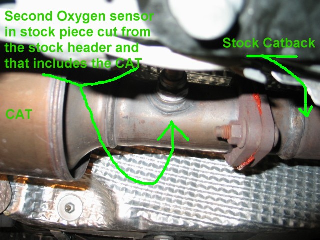

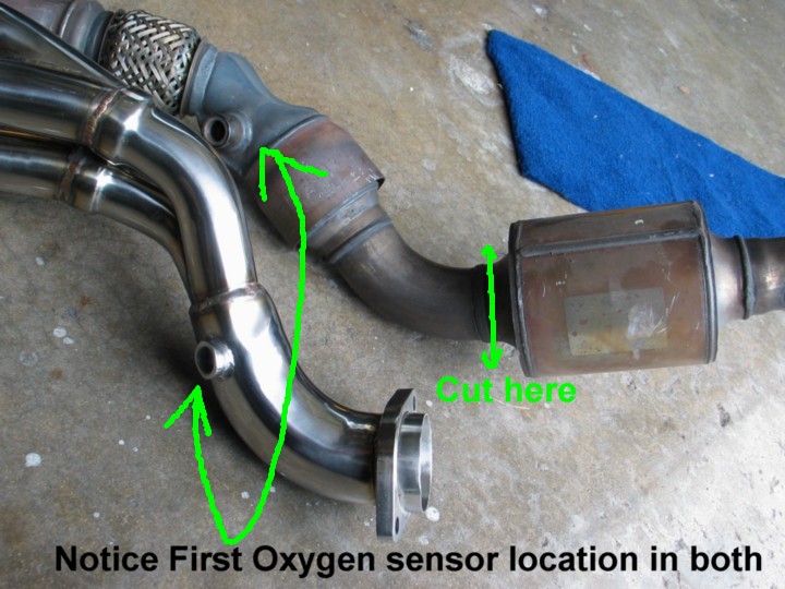

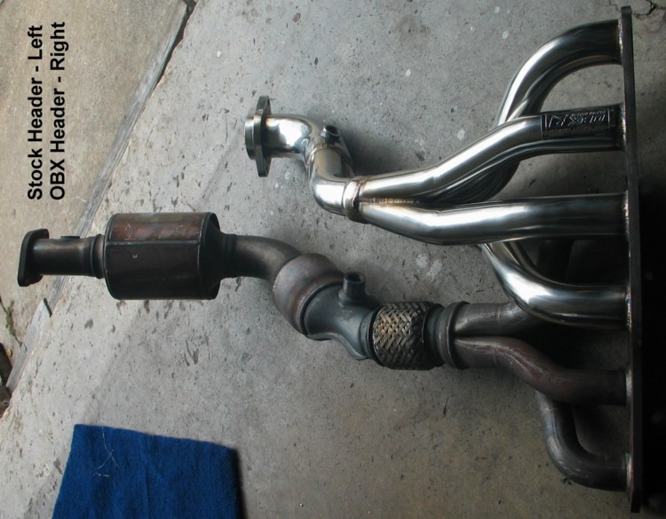

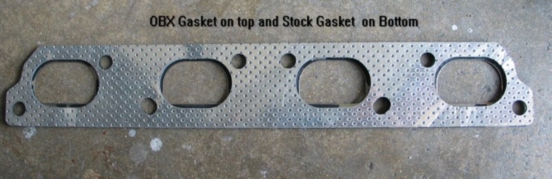

Posting some pictures in case anyone is interested. They show the difference between Stock vs. OBX Gasket, oxygen sensor location and overall construction. So far, it has made so little impact on the noise level that I am probably going to go with the One Ball mod.
bomboasy
bomboasy

I installed the OBX header after removing the stock header. The shop cut the stock header at the CAT. The Cat, opening for the second oxygen sensor and flange that attaches it to the catback would be the piece that you keep. Weld that to the little piece, looks like the end of a trumpet, that comes with the OBX.
