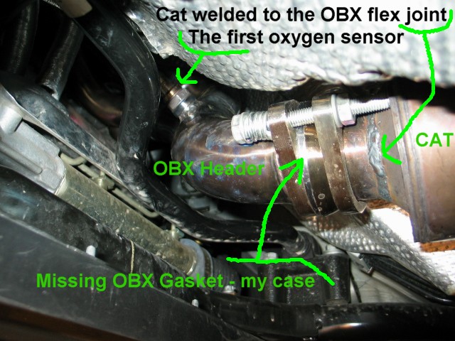

OBX-Racing Header Dyno Results!-obx_cat_flexjoin.jpgDon't over tighten the flex clamp or it won't flex except by destroying the donut. You can double nut if concerned about loosening.
The nice thing about this system (seperate cat) is that you can ceramic coat the inside of the header also. If you intend to coat the cat also I would recomend doing the fitting & welding first, using an aftermarket cat so you can reinstall the oem system while coating the other. Also you can eventually sell your stock setup to someone who burned theirs out & wants to remain stock.

Ok....someone tell me real quick cuz im to tired to read back this thread.......Does the OBX bolt right up with no cutting,welding or anything needed to install it???
Old Aug 16, 2005 | 06:46 AM
  #218
Dr Obnxs's Avatar
Dr Obnxs
iTrader: (7)
Joined: Sep 2004
Posts: 10,340
From: Woodside, CA
Yes and no....
so you have to read to find the details!
The deal is that the header bolts right on, but has a mating flange that needs to be welded to SOMETHING. Your options are
No cat, weld to tubing.
Stock cat, cut and weld original header.
Aftermarket cat, weld to flange, and then figure out what to weld on the end!
TY for doin my dirty work.
Now does it throw a CEL without the cat and do i need a O2 sim?
I would think as long as you place a cat upstream of the 02 sensor, you won't throw a CEL.
I can tell you for certain that the OEM cat welded to the mating flange does not throw a code. Several months and no CEL.

I posted those pictures. You use those pictures to show the welder where to cut the OEM cat and also where to weld it to the OBX header. You should be able to tell where the OEM cat was cut from them. If you use an aftermarket cat, YES you will have to add a pipe and a mating flange to connect to the Miltek catback. AND you have to make sure that the added piece allows for intallation of the Oxygen Sensor after the cat, or you will have an "engine service" light on. That is why is much easier to just cut the stock header. Regardless if you are using the OEM catback or other, you have to let the person doing the cat welding make any adjustments while the OBX header and catback are already installed.
Bomboasy
